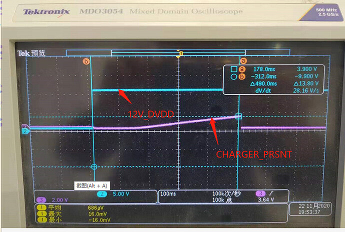

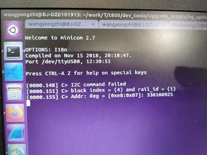

载板上没有电源按钮,是自动上电,当给上电时,当TX2有时候无法启动,串口没有任何信息打印,当这种情况发生后,按复位按钮就能正常启动。TX2没有启动时,TX2给载板的信号CARRIER_PWR_ON是高电平,载板是能正常上电。
附件图片是12V电源与VIN_PWR_BAD信号时序,12V电源与CHARGER_PRSNT信号时序。

We designed the carrier board according to OEM DG. 2 of the 50 carrier boards cannot be started normally. About 50 times of power-on startup, there will be 1 power-on startup failure. Observing the VIN_PWR_BAD signal and CHARGER_PRSNT signal with an oscilloscope is exactly the same as the normal startup. So I don’t know where else to check the circuit. When the power-on fails, TX2 can output CARRIER_PWR_ON signal to power the carrier board.

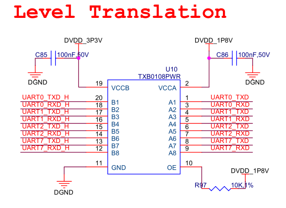

Strapping Pins:
The level conversion chip TXB0108PWR has no pull-up and pull-down resistors inside, and the other Strapping Pins are left floating.
