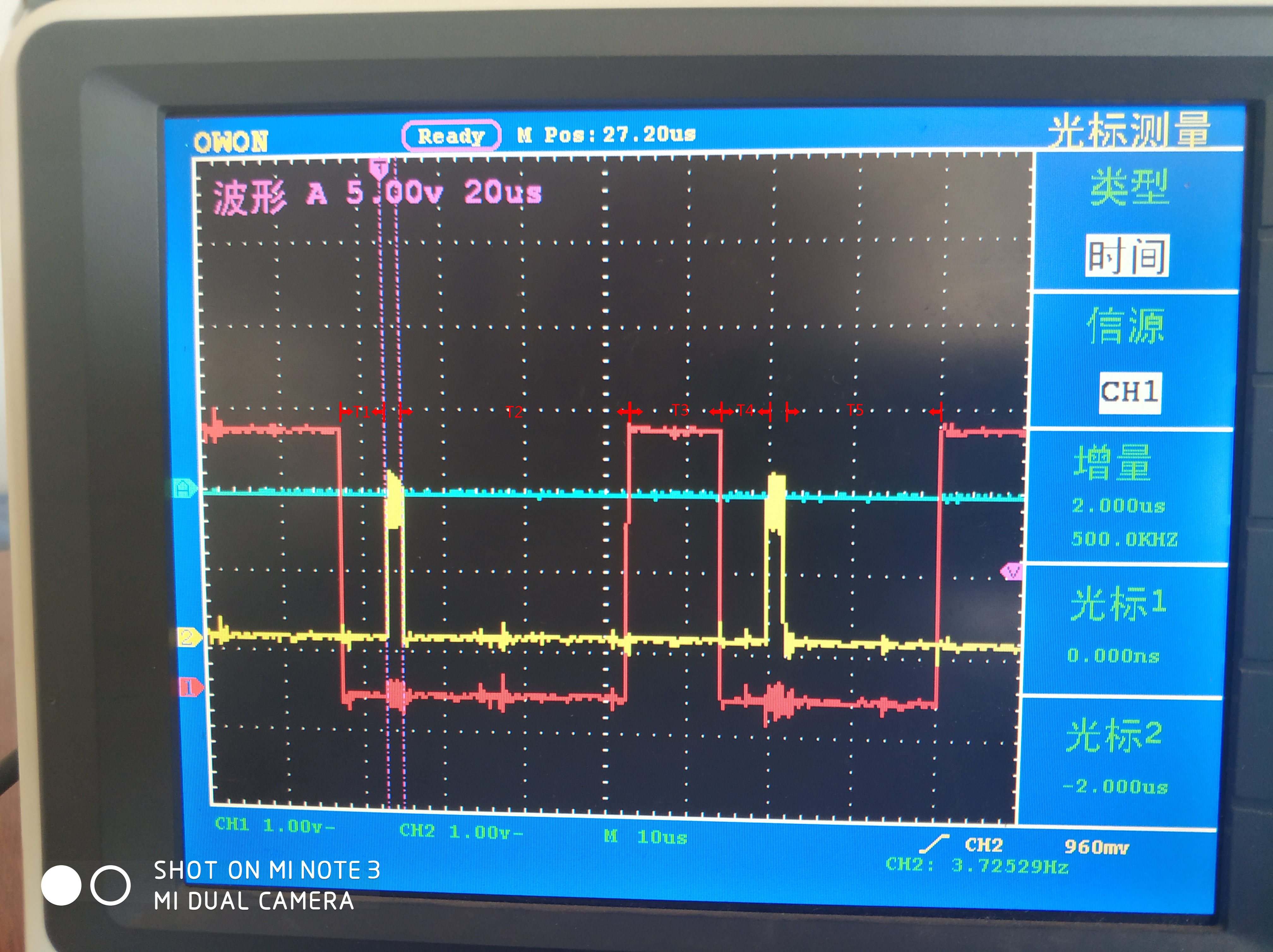

The function of our spi is ok,we can read&write data with spi interface.We just want to decrease the time be spent for a spi translation.
I have read these topics:
https://devtalk.nvidia.com/default/topic/1029410/jetson-tx1/spi-cs-issue/
https://devtalk.nvidia.com/default/topic/1037334/?comment=5270650
The wave of our SPI is wave.jpg.
The red line is cs,and the yellow line is MOSI.
The T1 is 5.6us,The T2 is 27.6us.  T3 is 11.2us.  T4 is 5.6us.   T5 is 18.4us.
How could I make the T1,T2,T3,T4,T5 as short as possible?

anyone have any ideas?
There is a bug in the code with spi driver,no one noticed it?
