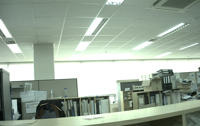

I used SF3325-100 Sekonix GMSL Camera.
& Run next command
/usr/local/driveworks/sample_camera_gmsl
Drive PX2 env
Driveworks Version: 0.6
CUDA 9
Drive AGX env
Setup with SDK Manger 0.9.14 (rev.0) - 4954.
Driveworks Version: 2.0
CUDA 10
1.Drive PX2 capture test
2.Drive AGX capture test
  • The Camera Exposure too high, so it Looks cloudy
  1. Drive AGX capture test
  • Image has a green noise
  • If the object moves fast, a purple afterimage remains
So, How can i solve this problem?
Dear jinsankim12,
DW uses Auto exposure mode in capturing images. We expect these kind of artifacts in office environment. Do you see the same outside? Also, please use ./sample_camera_gmsl --camera-type=ar0231-rccb-bae-sf3325 when using SF3325 camera module on DRIVE AGX.

  1. Drive PX2 Road environment Capture img
Still it Looks cloudy
  1. ./sample_camera_gmsl --camera-type=ar0231-rccb-bae-sf3325
    External Media
Same result
