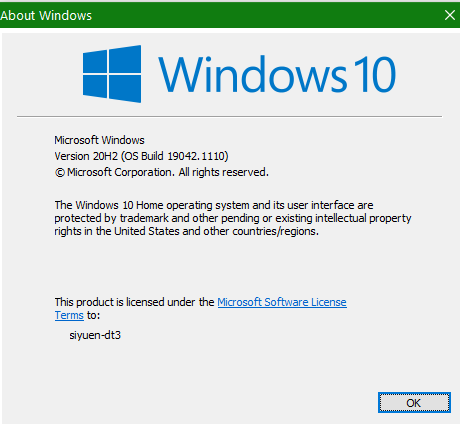

We support Windows10 version 1909+
Just to double check, can you try one more thing. Can you click on the windows button and type “winver” and post a screenshot of what you see there to confirm?
Much appreciate it. Thanks.
Other than Windows version, I also see you have an Assertion Error. You can also look at the FAQ here for how to get around this issue. Plus other information.
Thank you for your reply Siyuen. I reviewed all Assertion Error info and found only one of its kind that addressed a sound issue regarding “leaked contents” on line 1061. However my Assertion Error is on line 1081 and refers to “Subscriber 7 not found.”
I checked the WINVER information on Windows 10 as you suggested and was not aware Microsoft was not upgrading its builds. You are correct, my build shows as Windows 10 19042. I refreshed my updates but see no newer build offered. I ran the Windows assistant and it gave me this information instead. It states: “This PC is running version 20H2”. I see that the build and version are not the same thing. I do not understand how to get a newer version because when I attempt to ask microsoft to upgrade they tell me i have the latest version.
Ok looks like you are running the latest version. The screenshot from winver I am looking for is like this
Does seem like 19042 is one of the latest (post 1909) so that should be good. We have not run into this issue before so have to take a closer look. do you mind sending us the full log located here:

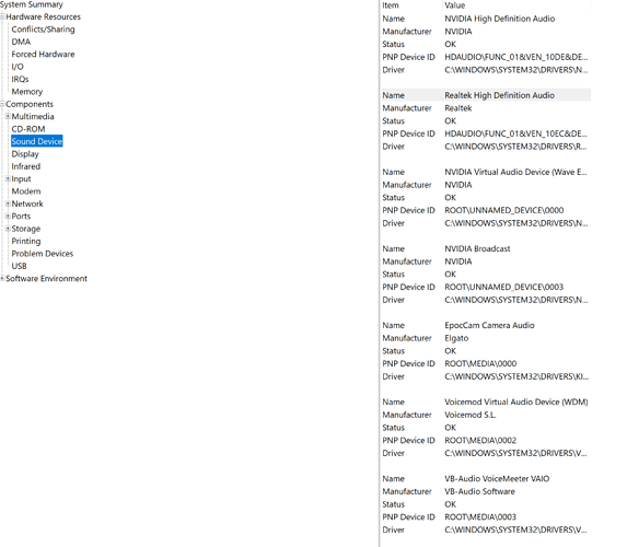

Just also curious, what kind of sound device do you have? Any external sound cards? Also are you running a non-English Windows version?
Understood. Omniverse log info:
launcher.log (624.5 KB)
Sound card is the onboard Realtek on the Aorus Master 570X motherboard. Standard English Win 10. Update Assistant allows 21h1 update now and so I began that after you mentioned I was behind :) I was holding off till they resolved the sound issues 21H1 update sometimes has. It say I am 87% there.

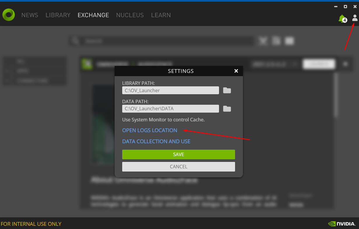

Could you post your audio2face log as well? It should be somewhere like “C:\Users\%user%\.nvidia-omniverse\logs\Kit\Audio2Face\2021.2”. You can also check the logs location from the launcher settings window.
Understood. Here are the A2face logs:

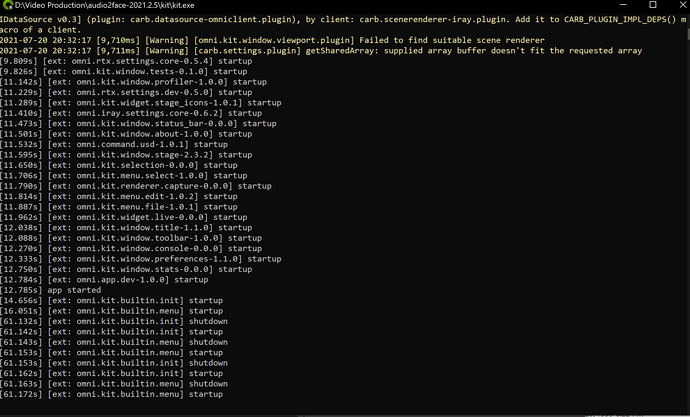

One other thing if you can help us test is to run the kit.exe file directly.
from the logs, yours would be here:
D:/Video Production/audio2face-2021.2.5/kit/kit.exe
This would run Kit as it is without any a2f extensions.
Create and Machinima all work fine.
You were correct, I attempted the kit.exe approach w/o extensions and it booted up the program successfully. Just so you know I had deleted A2face and did a fresh install in case it was corrupted. There was no change. The full program still will not boot up.
Only possible flag I noticed was in yellow while booting in verbose mode:
