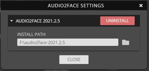

Took a look at the log, seems there are some permission issue here. This is an odd one as we have not seen this, but just for testing, if you made sure directory permission is open there, see if that would work? This should not need to be done but just for testing see if that helps.
021-06-22 09:32:43 [5,895ms] [Error] [carb.python] Node generation on f:/audio2face-2021.2.5/exts/omni.anim.shared/omni/anim/shared/ogn\python\nodes\OgnXformQuery.ogn failed with error Destination directory “f:/audio2face-2021.2.5/exts/omni.anim.shared/omni/anim/shared/ogn\docs” is not writable
No luck. I installed it twice on another ssd and the boot ssd. I made sure the I gave permission to the file directory. On the 3 drives.
kit_20210627_141733.log (116.3 KB)
Here is the most recent log file.

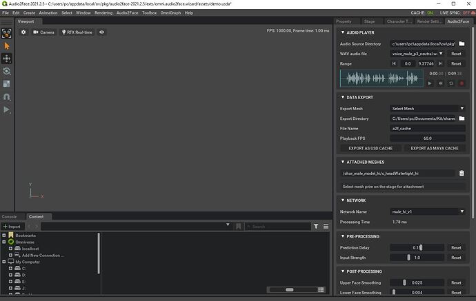

I’m having a similar issue as Stevesparkes. The app launches and doesn’t crash - I am able to navigate around and hear the sound provided etc. but I do not see anything in the viewport. I have tried all fixes provided earlier and nothing seems to work for me so far.
My Microsoft Windows Version is 20H2 (OS Build 19042.964)
Graphic Card: NVIDIA GeForce GTX 1080TI - driver version: 471.11
Audio2Face version 2021.2.5
Hi @ce_llochica ,
Thanks for your interest in trying out Audio2Face.
The current requirement for the app is an RTX card. GTX card is currently not supported.
Hope you are able to get an RTX and experience the A2F app in the future :)
