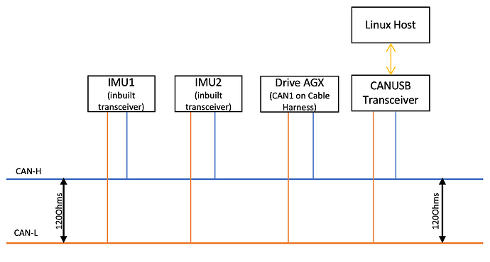

We did one more experiment. Below is the setup:
In this experiment, We see data from both the IMUs on the Linux Host when Drive AGX is not connected to the bus. As soon as we connected Drive AGX we stop seeing data from the IMUs to the Linux Host. When we remove the Drive AGX, the traffic was back up.
Note: For termination we are using one of this at each end: CAN Terminator with 120 Ohm Resistor – Grid Connect. And none of the IMUs have in-built termination.
Can you help us how else we can debug this, what else we can try to narrow-down the problem?

What does “Drive AGX (IMU1 DB9)” mean? the IMU connector on the cable harness? Why don’t you use the CAN connector on the cable harness?
Thanks for the reply @VickNV .
It was a mistake in tat diagram, this is the updated diagram. I am connecting to CAN1 DB9 connector on harness. Which has two DB9 labels Can1 and Can 2. From those labels I am using Can1 pin 7/ pin 2. Sorry for misunderstanding. I am aware of the fact that IMU connector uses UART.
Without IMU1 and IMU2 CAN devices on the CAN bus, is the CAN communication between Drive AGX and the Linux host (via the CANUSB transceiver) working?
When I connect Drive AGX and Linux host, and send data from Linux using cansend, I see the message on AGX candump.
When I connect my IMU to above setup (IMU + Linux + AGX), the IMU sends some data and stops sending data after few messages. But again, a message using cansend from Linux go though to the AGX. Then I restarted my IMU and same thing again, sent some data and then stopped but Linux - AGX CAN communication was working.
When I connect the IMU to the Linux, i see continuous data sent from the IMU to the linux candump without any problem.

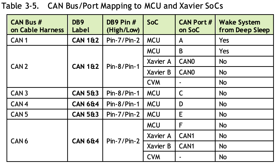

Please refer to “Setting up SocketCAN Interface” topic in the document (especially the notes) and check if all Xavier/Aurix/IMU use same bit timing parameters.

Thanks for pointing out to this thread. I think here the problem was pin connections on DB9 (1&7 instead of 2&8). I have created a network with CAN1&2 connected through pin 1&7 and CAN6&4 is connected through DB9 pins 2&8. And I am able to send commands from can0(CAN1&2) to can1(CAN6&4) and vice-versa.

In terms of the voltage level, on the DRIVE AGX cable harness, it should be 5V for the CAN interfaces. Please note that you need to have 120 ohm termination on both ends. On DRIVE AGX side, we only lightly terminate the bus. The 5V transceiver you are using might not have the 120 ohm termination. You can refer to “Figure C-4. Example of E3556 System Connections” in DRIVE AGX Developer Kit Product Brief (PDF) as an example of RTC module that connects to CAN 6&4.
