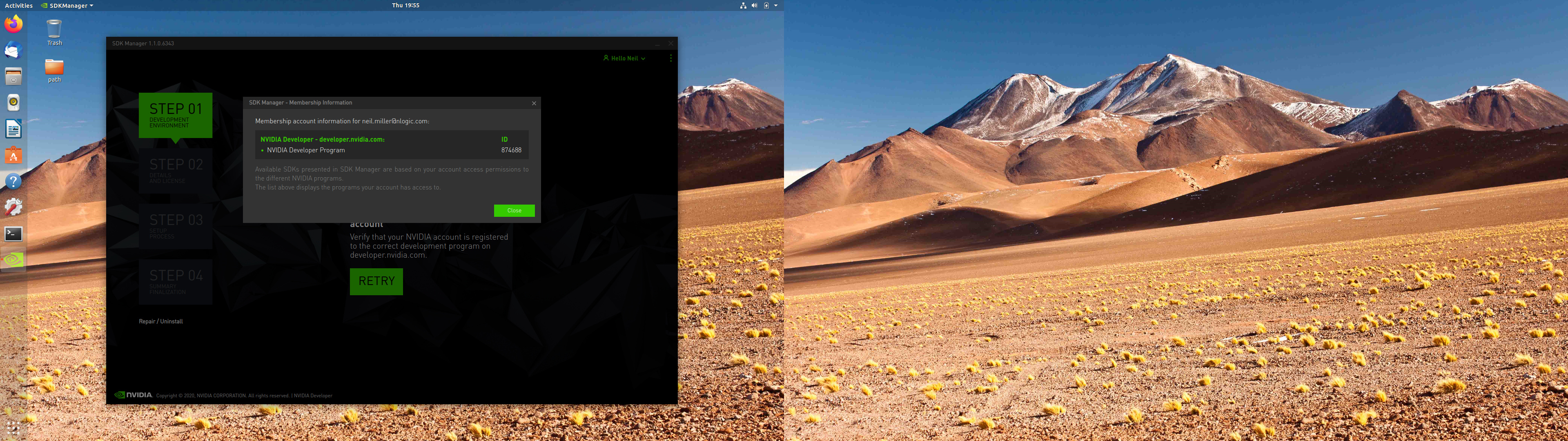

Sorry about that, I clearly misread his issue (or responded to the wrong forum post). Regardless, I’m able to login, but I can’t access the SDK for whatever reason. It just says “Oops, not SDK’s are available for your account” (even though I’m a member of the Nvidia developer program.
Is there a way to resolve this?
Please make sure you are on the latest SDKM.
  1. Upgrade to the latest SDK Manager version (1.1) – from: NVIDIA SDK Manager | NVIDIA Developer
  2. If problem persist, send us a screenshot of the account membership dialog (inside SDK Manage). More details are available: User Account Membership Settings :: NVIDIA SDK Manager Documentation
Thanks,
Tom
Tom,
If you look at the screenshot in my last post, it shows I have the most recent version of SDK manager (V1.1 build 6343) and it has a screenshot of the details of my developer program status and ID in it.
Let me know if you need any additional information. Thanks!

There is something wrong per the log:
2020-05-05 11:45:57.140 - error: sdkml1_repo.json download failed with error ETIMEDOUT, request url: https://developer.download.nvidia.com/sdkmanager/sdkm-config/main/sdkml1_repo.json
*2020-05-05 11:45:57.140 - error: *
{ code: ‘ETIMEDOUT’, messsage: ‘ETIMEDOUT’ }
Could you help to check:
  1. If you can download the URL https://developer.download.nvidia.com/sdkmanager/sdkm-config/main/sdkml1_repo.json in the browser?
  2. Are you behind a proxy to download files?
  3. What is your geolocation, maybe it is CDN issue.
  4. Could you confirm the problematic account is bulkmailinglist@yahoo.com?

can open both “http://developer.download.nvidia.com” as well as “https://developer.download.nvidia.com/sdkmanager/sdkm-config/main/sdkml1_repo.json” in the browser (the latter of which will allow me to download the json file).
If I ping them, “http://developer.download.nvidia.com” will give me results back, though it will be unable to ping “https://developer.download.nvidia.com/sdkmanager/sdkm-config/main/sdkml1_repo.json" (which makes sense, I don’t think you can ping file downloads).
Below is a screenshot of what I’ve attempted (you can see the json file attempt in the background and the ping attempt in the foreground).
I do not believe I am behind a proxy. I’m just connected via a home network to a windows pc into a virtualbox system.
I am in California.
I can confirm that that is the email address of the problematic account. Let me know if you need any additional information from me. Thanks!nvidiaattempts
I am in Alabama.
There is a performance issues on NVIDIA Developer server right now. It’s very likely that this is the cause. The team is working on this.
