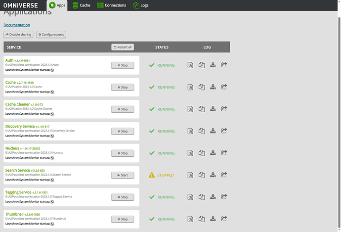

Can you enter this into your browser http://localhost:3080/ and click on the “Apps” tab. Are all the services running? can you screen shot that page and send it to us?

looking at the log, there seem to be several errors. among them are inability to retrieve GDPR and EULA, which i presume could be the biggest issue. do you have any firewall/antivirus/special network configuration? also, can you also make sure that all the services in the System Monitor is active and running (you can find it by clicking on the hamburger icon under the Exchange and go to settings)?

yea, the same connection issue stemmed back to Aug 2nd. OV hasn’t been able to access the necessary files (C:\Users\ASUS\.nvidia-omniverse\config\auth.toml being an important one) can you try clicking on the ‘Start’ button next to ‘Search Service’ from the System Monitor (the one currently shown as stopped) and try restarting the OV Launcher?
I have tried the method you mentioned, but when I clicked the “start” button, it did not have much effect. After starting, it immediately got error and then stopped. I downloaded the log file of the server, which you may need. Thank you very much for your help and taking time out of your busy schedule to answer my questions
Search Service.log (3.6 MB)
sqlite3.OperationalError: unable to open database file
