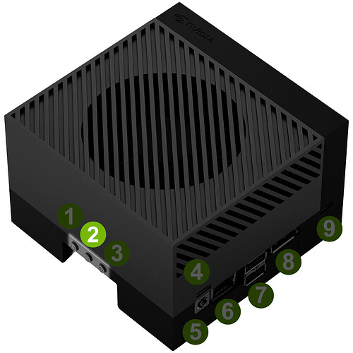

Did you note the step to put the device into recovery mode where it can be controlled via USB by the SDK manager?
While holding the middle Force Recovery button ( 2
), insert the USB Type-C power supply plug into the USB Type-C port above the DC jack.
This will turn on the Jetson dev kit in Force Recovery Mode.
