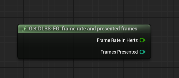

I spend a few hours in implementation and without any success, I recorded a video what and how I did, as a result, I can see that it is changing the settings, but it does not influence my FPS at all. Can somebody take a look and suggest what I did wrong? Thx
I haven’t watched the whole video, but there’s something I want to check because I didn’t see the part where you measure FPS.
Unreal itself doesn’t know how much frames are generated by DLSS-FG.
You can get the FPS with this function or use a separate FPS measurement program like the Nvidia overlay.
Even if you’ve already used this method, I’m writing it down in case it helps others.
Thanks for pointing that out @jof4002!
Welcome to the NVIDIA developer forums @tvwk2013.
jof4002’s suggestion is what I would say as well. Sadly the in-editor FPS stats do not reflect the actual final output FPS after DLSS etc.
Thank you both of you!! Yes, it was the problem as you describe, I added node which you suggested and it shows the real FPS!!!
