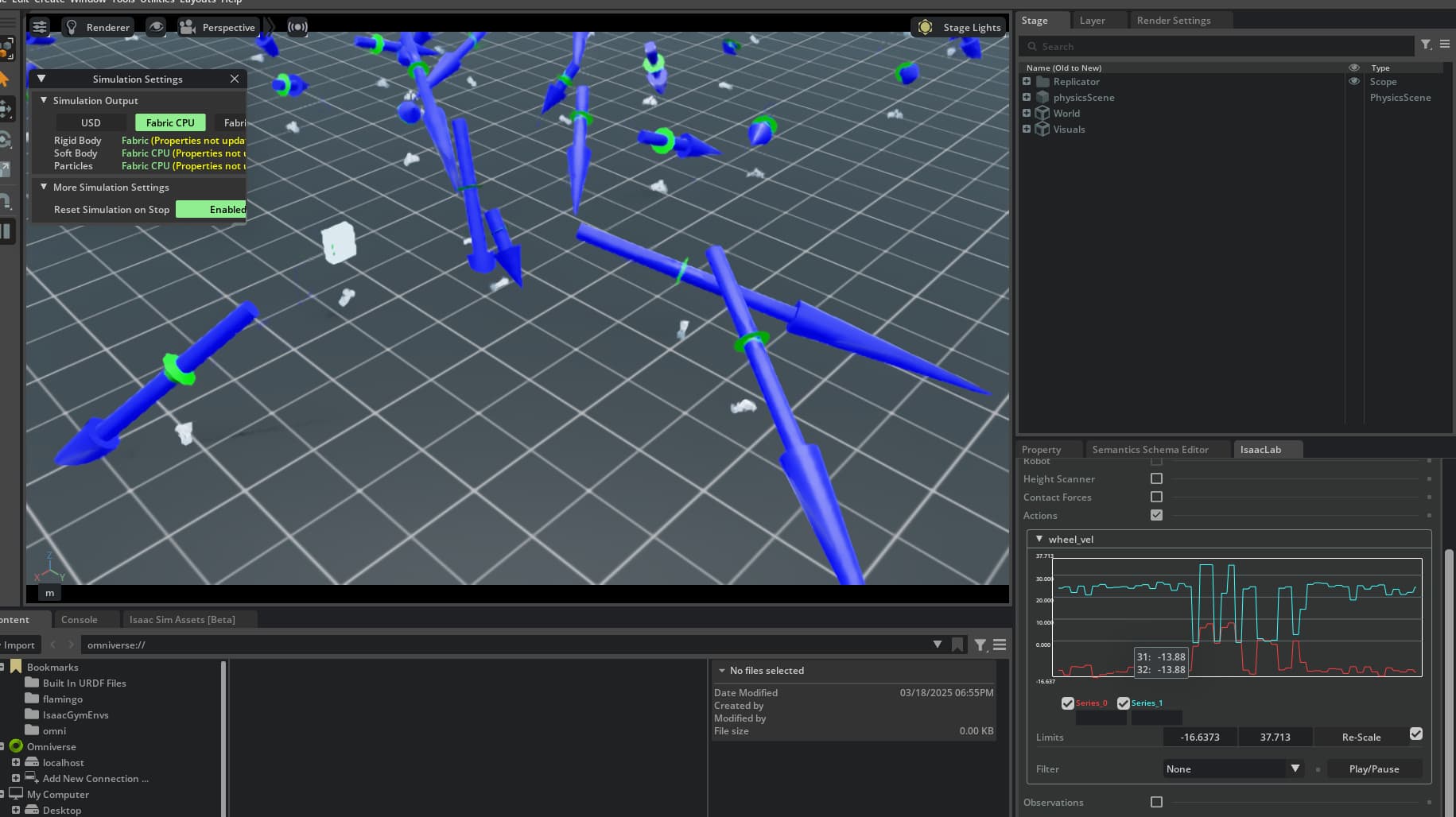

I loaded the TurtleBot3 Burger USD file from Isaac Sim Assets into Isaac Sim, then saved it in my lab workspace for training in Isaac Lab.
To control the two wheels using velocity control, I used DelayedPDActuatorCfg and set the velocity_limit to 6.4. However, as seen in the attached image, the wheel velocity significantly exceeds 6.4.
I tried setting stiffness to 0 and 40.0, but the results remained the same. I am not sure what the issue is.
In fact, to control my own two-wheel robot in Isaac Lab, I converted a URDF file from SolidWorks, then converted it to a USD file using Isaac Sim, and attempted to train it in Isaac Lab, but it did not work properly.
After multiple attempts without success, I tried using the TurtleBot3 Burger instead. However, I discovered that the TurtleBot3 Burger had a similar issue to my robot.
Below is my code.
