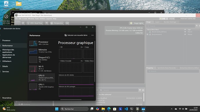

I’m experiencing a freeze when launching Isaac Sim 4.5 on my laptop. The application becomes Not Responding shortly after showing the menus, even when the stage is completely empty. Task Manager shows 0% GPU usage during the freeze.

  4. Check Task Manager → GPU usage remains at 0%.

Please refer to 5070ti GPU cannot be used in isaac sim 4.5.0 and upgrade to Isaac Sim 5.0.0.
Yes, it worked. The freeze still occurred in 5.0 because Isaac Sim was downloading and processing assets the first time it was opened. I confirmed this by observing the high CPU and disk usage. After a few minutes, it started working normally.
