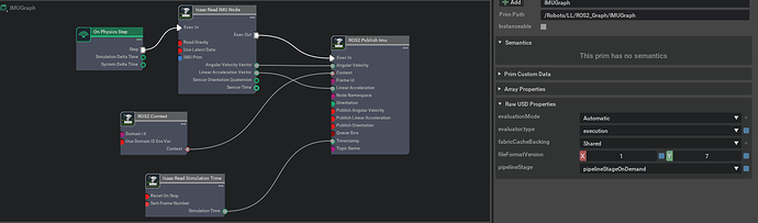

I have now figured out that one can make it work with the omnigraphs.
For others here the solution:
  • Can use Omnigraph
    • Use On Physics Step and not On Playback as ticking element in the graph
    • In the setting of the graphs who should use Physics time change the pipelineStage to use OnDemand
    • Under Layer → physicsScene set the Time Steps Per Second to a high enough value (somehow does not correlate 1-1 to the rate then observed during publishing. E.g using 800 yields 180fps with 2 cameras publishing and 280 fps with one)

Thanks a lot, yes I was using that and sometimes this showed also higher rates than what was coming from the fps of the renderer, however not the rate from the physics step but some intermediate rate. I have set Time Steps per Second = 100.
I have my IMU graph which reads the sim time and uses on physics step
I also have the clock graph like you have shown which uses on physics step as well

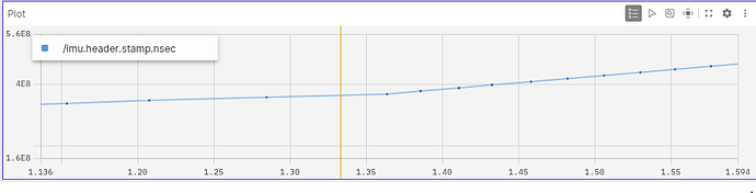

Coming back to the timestamps, alse the IMU data is still not published at 100HZ, as one can see in the plot are there times which have for roughly 0.07s, what makes me believe then, that the imu data is not published at a stable rate and does not match with what to robot is experiencing (acceleration).
Here a plot showing for both on the one hand that if I use the time from the header the rate is now 100hz (which should not be for the camera) and that using the recording time they are again both back at the render time
What changes are required such that the imu data is reliably published at 100hz and the camera at a way lower rate (which I can specify)? And that the timestamps for each of them are actually the ones where the data is from.

@yhofmann Please don’t use the time you receive the message because this is the wall time. Please use the timestamp in the message header. Since you increase the IMU publish rate, the sim time may not align with real time.
@zhengwang, Alright so one should use the header time for both the camera and IMU topic. Therefore one could use rosbags but not the realtime simulation for further processing pipelines. One would then need to have two ros2 clocks to have a higher rate for the imu and a lower for the camera, where the problem of the simulation gate not working to lower the rate of the camera beeing rendered would still exist.
In consequence would this also mean that the simulation starts to slow down with higher number of timesteps per second for physics if one wants a high rate for the IMU.
Can you confirm that this is the best way to have use Isaac Sim to get high rate IMU data and rendered images?
Yes. When you are constraint on computation power but you want to achieve high frequency data, your simulation would be slower than real time. On the ROS2 side, please also make sure use_sim_time is true to align with Isaac Sim.
