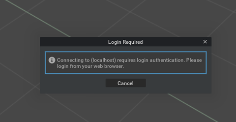

I could not open the local Nucleus server since yesterday. I keep getting the following message.
I asked some of my friends and it seems they all have this same issue. We are in China. Is this a network issue or something?
Hi, are you running Isaac Sim from the Launcher? Have you installed Nucleus and does the browser pop up to a login window?
Yes, I run Isaac Sim from the Launcher and Necleus is installed and worked all the time until two days ago.
No, there is no login windowed poped up.

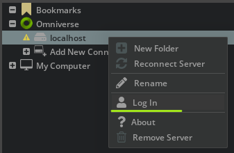

iirc, if it’s having issue connecting to localhost, you should be seeing a yellow ! icon next to localhost in Isaac Sim, correct?

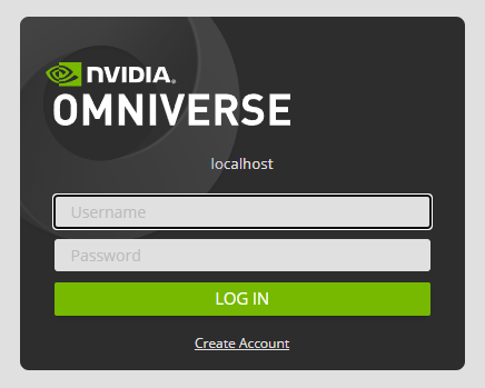

if so, can you try right clicking on the localhost server and choose to log in? it should then open a new tab in your browser (hence my question) and see authentication prompts:

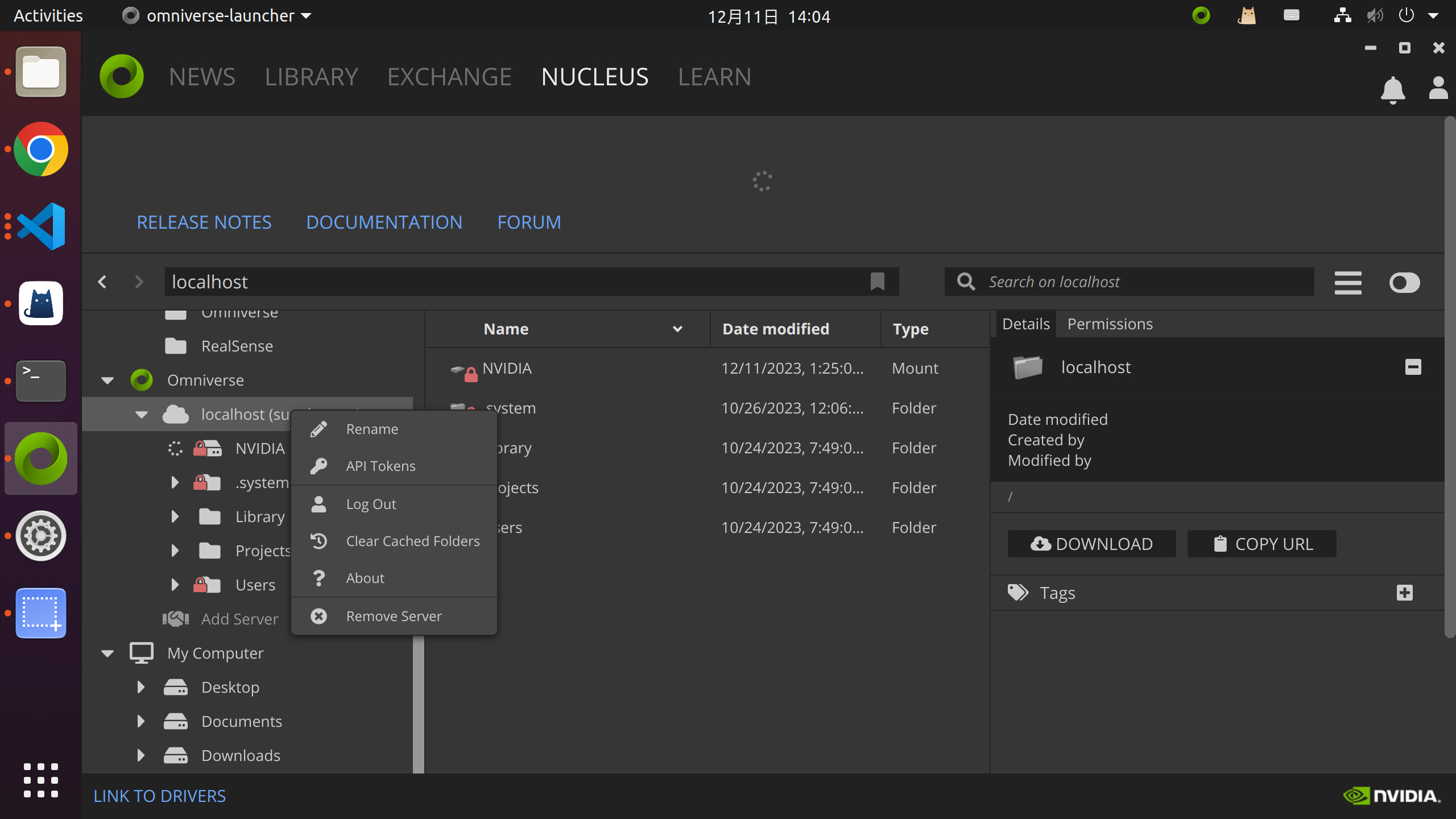

I actually have logged in. But the content of folder ā€œNVIDIAā€ does NOT load.
is it only on the NVIDIA folder? if it keeps spinning and not load, you could try quitting the OV launcher for good and restart the launcher. if you aren’t able to load the folder, that could be the GDPR issue and not being able to fetch the contents within.
and just in case, here’s the endpoints connectivity and ports information - Networking and TCP/IP Ports — Omniverse Nucleus latest documentation (thought you didn’t have this problem before, so i could only speculate some config/setting got changed somewhere somehow)
try to log out and then back in through the OV launcher and see if the wheels are still spinning.
I tried logout and login again in OV, but still no luck. :(
