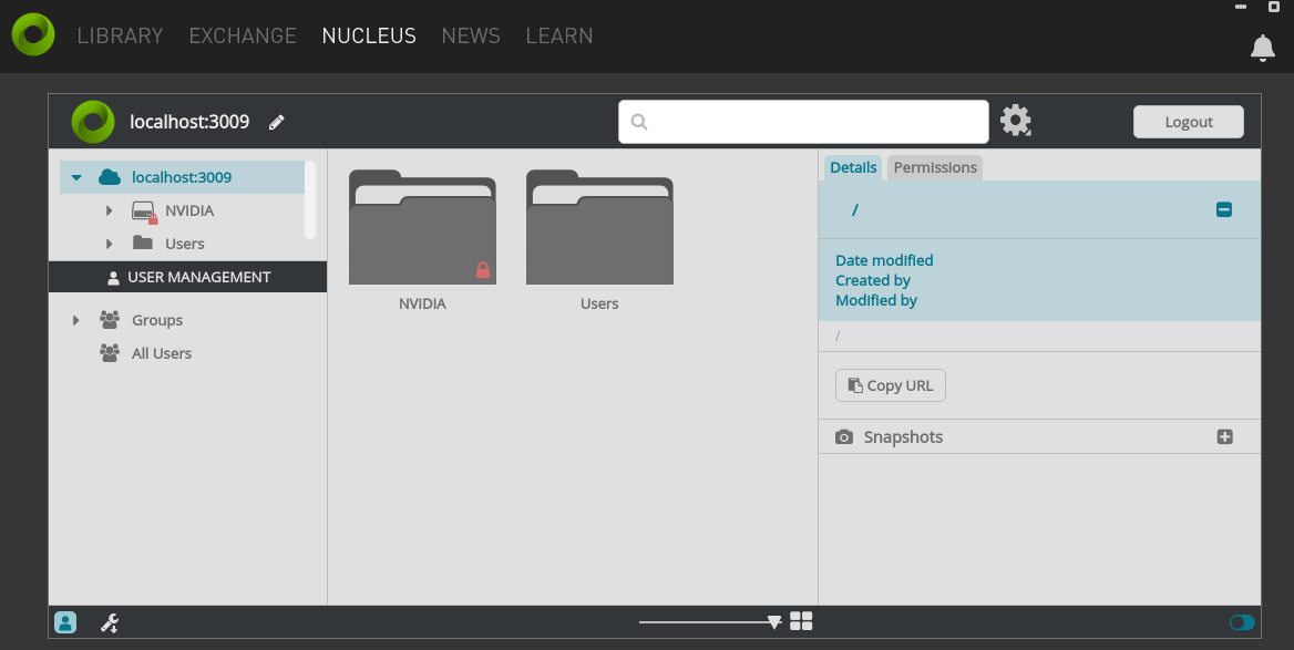

I recently saw the update to 2021 and was excited to try upgrading my system and try out the new launcher.
I successfully installed Isaac Sim and created a new Nucleus Workstation using the launcher. Now having used previous Isaac Sim installations I had a local Nucleus Installation but I wanted to switch to the new system.
When I first opened Isaac Sim I could see that it was looking at the old Nucleus installation with my old Isaac assets. I only created the new Nucleus Workstation after I noticed this. I was trying to figure out how to get it to see the new Nucleus Workstation and I don’t know what I did but now I am getting the following in Isaac Sim
As you can see this localhost is currently completely empty which differs from what I see on the Nucleus Server
Do you have any idea where I might have gone wrong and how to correctly sync up Isaac Sim with my new Nucleus Workstation?
Any help is appreciated as I am keen to see what I can do with the new beta release
Hi, here are the steps to uninstall the old Nucleus server.
sudo systemctl stop omniverse-server
sudo systemctl stop omniverse-asset-converter
sudo systemctl stop omniverse-cache
sudo systemctl stop omniverse-indexing
sudo systemctl stop omniverse-snapshot
sudo systemctl stop omniverse-thumbnail
sudo systemctl stop omniverse-web
sudo rm -rf /var/lib/omniverse
sudo rm -rf /opt/nvidia/omniverse
sudo rm -rf /etc/systemd/systemomniverse-*
sudo rm /lib/systemd/systemomniverse-*
sudo systemctl reset-failed
Next reboot the system.
You may need to uninstall and reinstall Nucleus is this page does not look right:
http://localhost:3080/
All services should be running.
We will update the documentation with these instructions above.
Thanks that seemed to do the trick for me.
