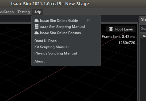

I am also very excited by the possibilities for subsea applications for Isaac Sim. I think the Python API for Omni-PhysX is probably the best place to start for the lift/drag/thrust model, you can find the docs from the Isaac Sim menu under Help–>Physics Scripting Manual. I believe that an effective and efficient model for a basic ROV or UUV can be built without requiring engine changes or new C++ extensions, so we should probably start there. For silt and turbidity I believe we can build something on top of the Flow extension for Omniverse, but it will probably require some attention from the engineers who write that extension.

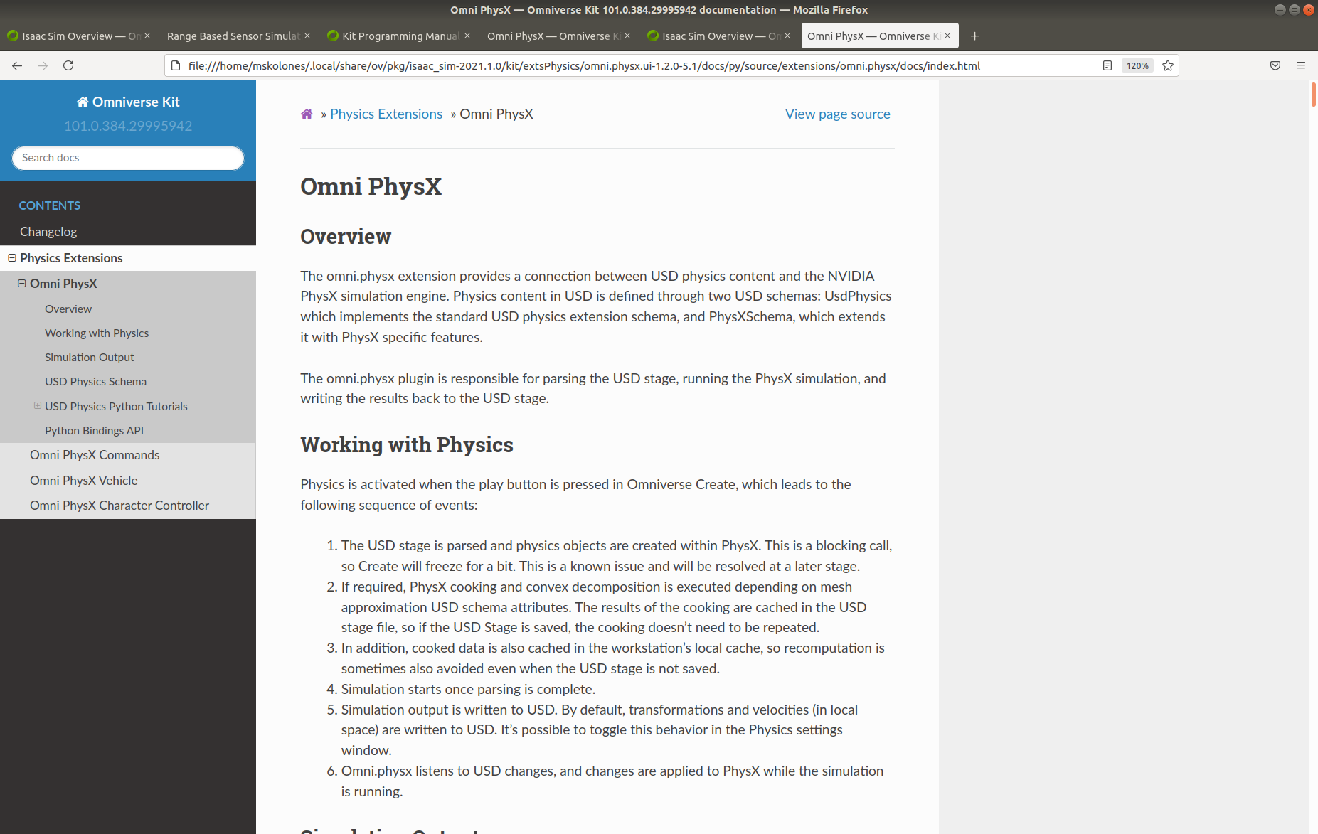

Hi Mike, thanks so much for the quick reply. I am glad to hear this is on the radar for Isaac Sim, and I would be very interested in your ROV example when it becomes available! I will also check out the PhysX scripting manual as you suggested. Is the PhysX API still 4.1 or does it support 5?

PhysX-5 is the physics library in Omniverse / IsaacSim exposed through the Python APIs.
C++ extension authoring will become available to end users, but this will take some time, I don’t expect to see that supported until 2022. Pretty much everything is exposed in Python already, so C++ development is really only important for performance-critical pieces like building new sensors straight off the rendering pipeline.

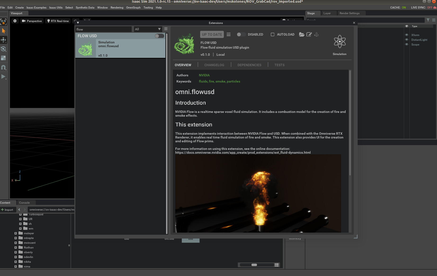

Flow should be available to you already, go to Window–>Extensions and type ‘Flow’ into the search field. There are many Omniverse extensions available in IsaacSim that aren’t obvious at first glance, you have to enable them through the Extensions panel.
