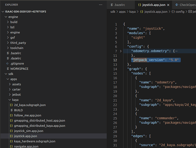

Isaac SDK 2020.2 should work with Jetpack 4.5. You may see a “CheckOperatingSystem codelet” warning which you can ignore or reconfigure the codelet to fix.
Here’s a note from the downloads page:
You may notice errors from “CheckOperatingSystem codelet” as the sample apps are configured by default to check for Jetpack 4.4.1. Please set the config section of the app JSON file to check for Jetpack 4.5 i.e. ( “jetpack_version”: “5.0”).

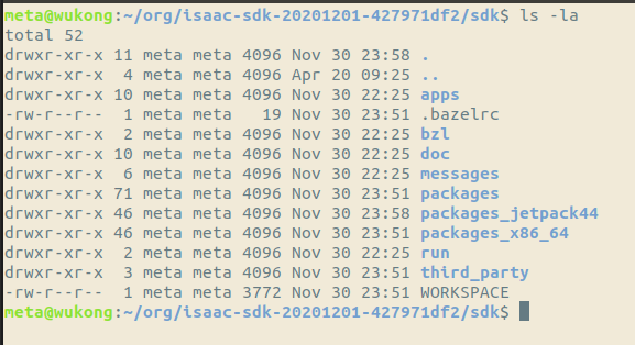

but i dont see a file called jetpack44 or jetpack50 at
isaac-sdk-20201201-427971df2/engine/engine/build/
where the deploy.sh script is at
or from the path where i ran the command from. namely
isaac-sdk-20201201-427971df2/sdk

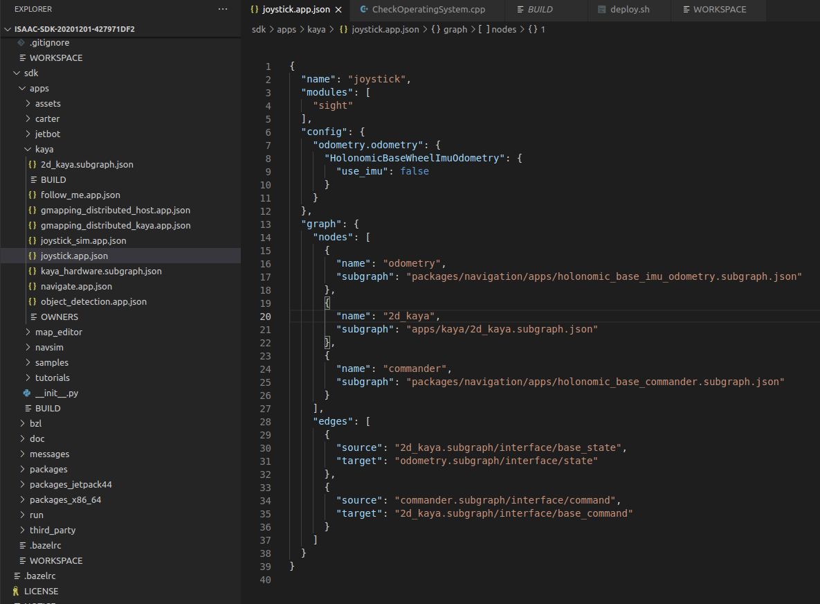

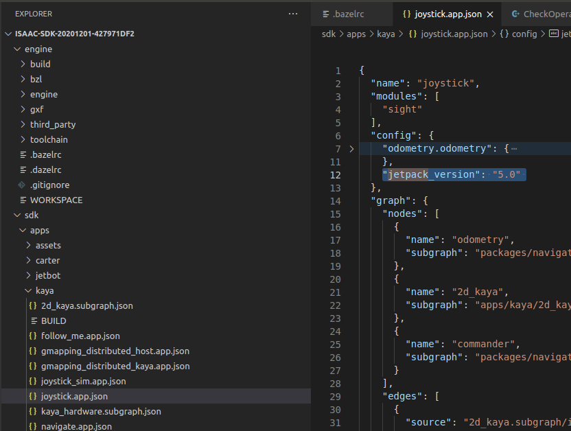

at my application folder ( the joystick app ) i see json files but no reference to a place where i can insert your suggestion of jetpack50
isaac-sdk-20201201-427971df2/sdk/apps/kaya/joystick.app.json

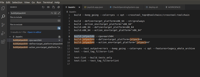

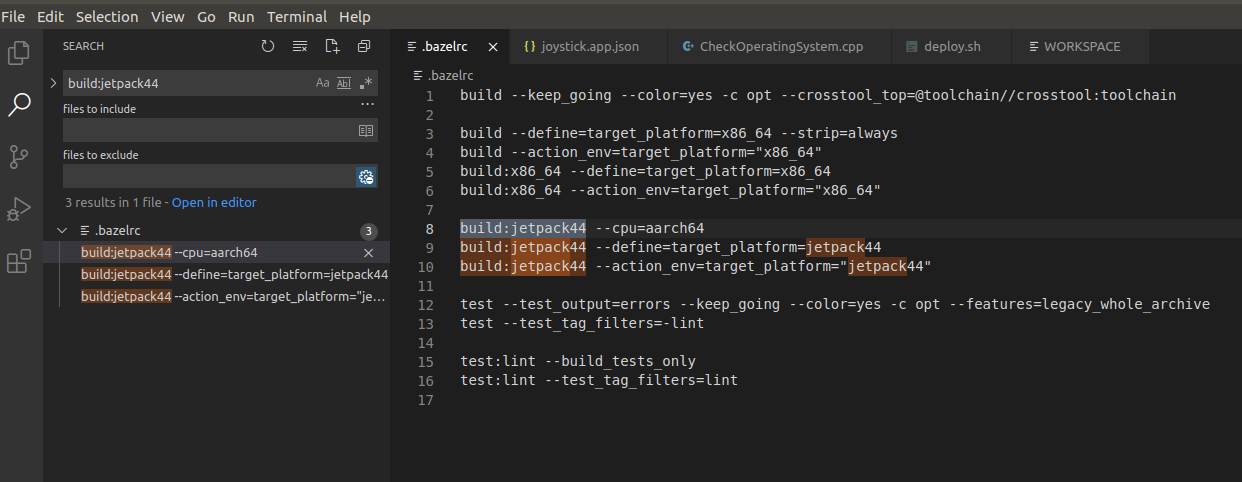

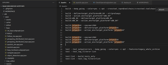

theres a bazelrc file at
** isaac-sdk-20201201-427971df2/.bazelrc**
which i will presume toggles a set of variables to be used in the build.
-d jetpack44
becomes
bazel build --config jetpack44
and referred to in
build:jetpack44 --cpu=aarch64
build:jetpack44 --define=target_platform=jetpack44
build:jetpack44 --action_env=target_platform=“jetpack44”
also by the way
JetPack is at version 4.5.1
so do you really mean ( “jetpack_version”: “5.1”)
instead of ( “jetpack_version”: “5.0”)
are you guys sure this works for jetpack 4.5.1 ???

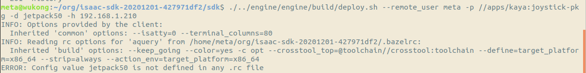

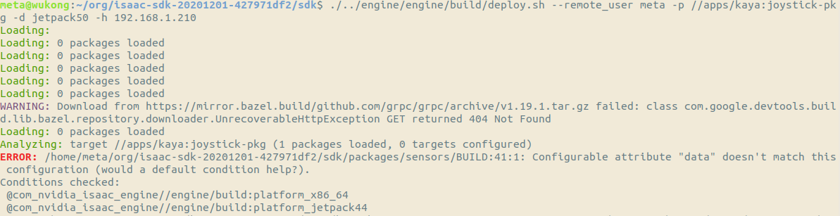

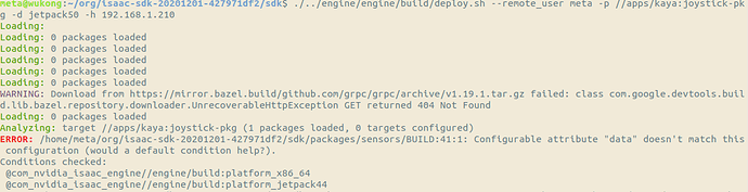

ERROR: Config value jetpack50 is not defined in any .rc file
so i added to bazelrc the following to fake it.
and the code ends up trying to load up things that dont exist because your SDK code is tightly tied to file system names and bazel switches
i ended up running
./../engine/engine/build/deploy.sh --remote_user meta -p //apps/kaya:joystick-pkg -d jetpack44 -h 192.168.1.210
so basically just lie and say its going to jetpack44

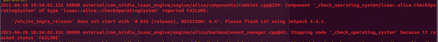

when i run it on the kaya i get
2021-04-28 19:54:02.151 ERROR external/com_nvidia_isaac_engine/engine/alice/components/Codelet.cpp@229: Component ‘_check_operating_system/isaac.alice.CheckOperatingSystem’ of type ‘isaac::alice::CheckOperatingSystem’ reported FAILURE:
**'/etc/nv_tegra_release' does not start with '# R32 (release), REVISION: 4.4'. Please flash L4T using Jetpack 4.4.1.**
2021-04-28 19:54:02.151 ERROR external/com_nvidia_isaac_engine/engine/alice/backend/event_manager.cpp@43: Stopping node ‘_check_operating_system’ because it reached status ‘FAILURE’

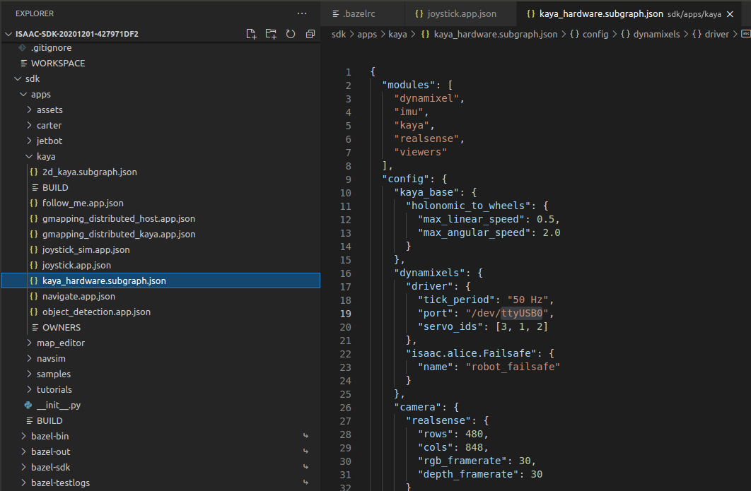

and then i get

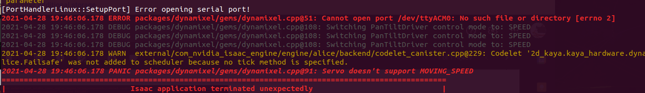

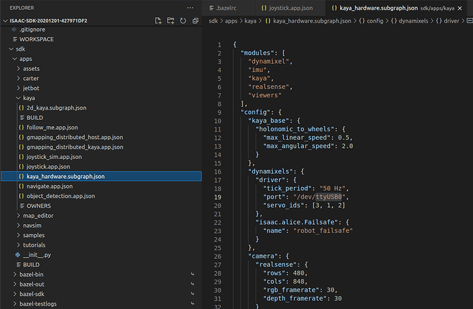

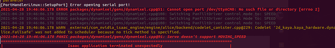

2021-04-28 19:46:06.178 ERROR packages/dynamixel/gems/dynamixel.cpp@51: Cannot open port /dev/ttyACM0: No such file or directory [errno 2]
which is not a device on my jetson.
so i did a search and replace and replaced all occurrences of ttyACM0 with ttyUSB0

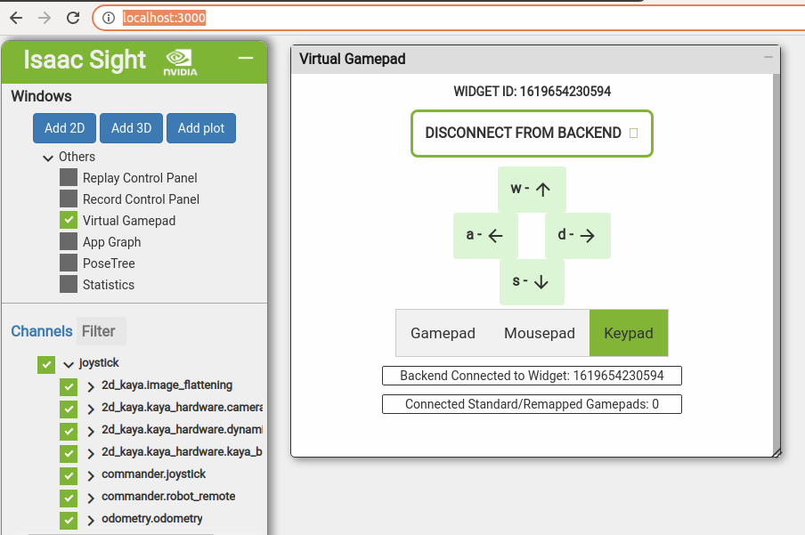

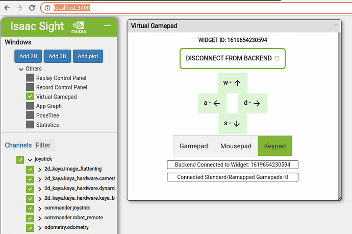

and i was able to control the robot with the keypad in issaac site
which is the website thats spawned to monitor the application
localhost:3000

Yes, “-d jetpack44” deploy to jetpack 4.5/4.5.1 (while unsupported) works.
The parameters of the CheckOperatingSystem codelet can be updated in the following way, to prevent it from reporting the failure:
“config”: {
“_check_operating_system”: {
“isaac.alice.CheckOperatingSystem”: {
“jetpack_version”: “4.5.1”,
“jetson_release_version”: “# R32 (release), REVISION: 5.1”
