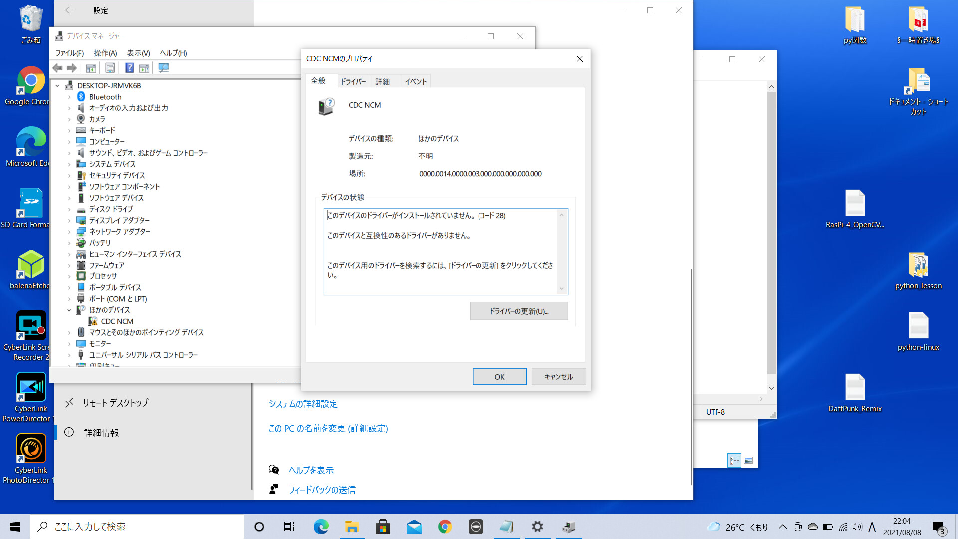

When I tried to use Headless mode and connected with Jetson Nano 2GB in using USB-cable and Windows Power Shell, ‘ssh @192.168.55.1 connection timed out’ happened very often.

on Device-Manager, the other device: CDC NCM (this is Jetson Nano 2GB, I think)

The address 192.168.0.21 is not from the micro-B USB cable virtual networking. On the Jetson though the screenshots make it nearly impossible to see which address belongs to what, so can you post the output (on the Jetson) from “ifconfig” and “iwconfig”?
This next will probably seem a bit strange, but a Linux machine can be used to self-debug in some cases. If on the Jetson you monitor “dmesg --follow”, and then you connect the micro-B USB cable at one end to the Jetson, and the other end to the full-sized USB type-A connector, what shows up in “dmesg --follow” from that cable plugging in?
Btw, you could “ssh 192.168.0.21”, but I doubt “ssh @192.168.0.21” is valid unless it is a “Windows thing”. However, let’s say the account name on the Jetson is “nano”; then you could use “ssh nano@192.168.0.21”…notice how the “@” is always used with an account name. This of course won’t help since the connection times out…such an error indicates whoever you’ve run the ssh connection attempt to isn’t “answering” (different than no route, which would be network failure…in this case the network route seems to exist, but the ssh server is not even allowing an attempt to use it). I suspect you can ping unless there is a firewall in the way, so does ping work? For example, from Windows:
ping 192.168.0.21
