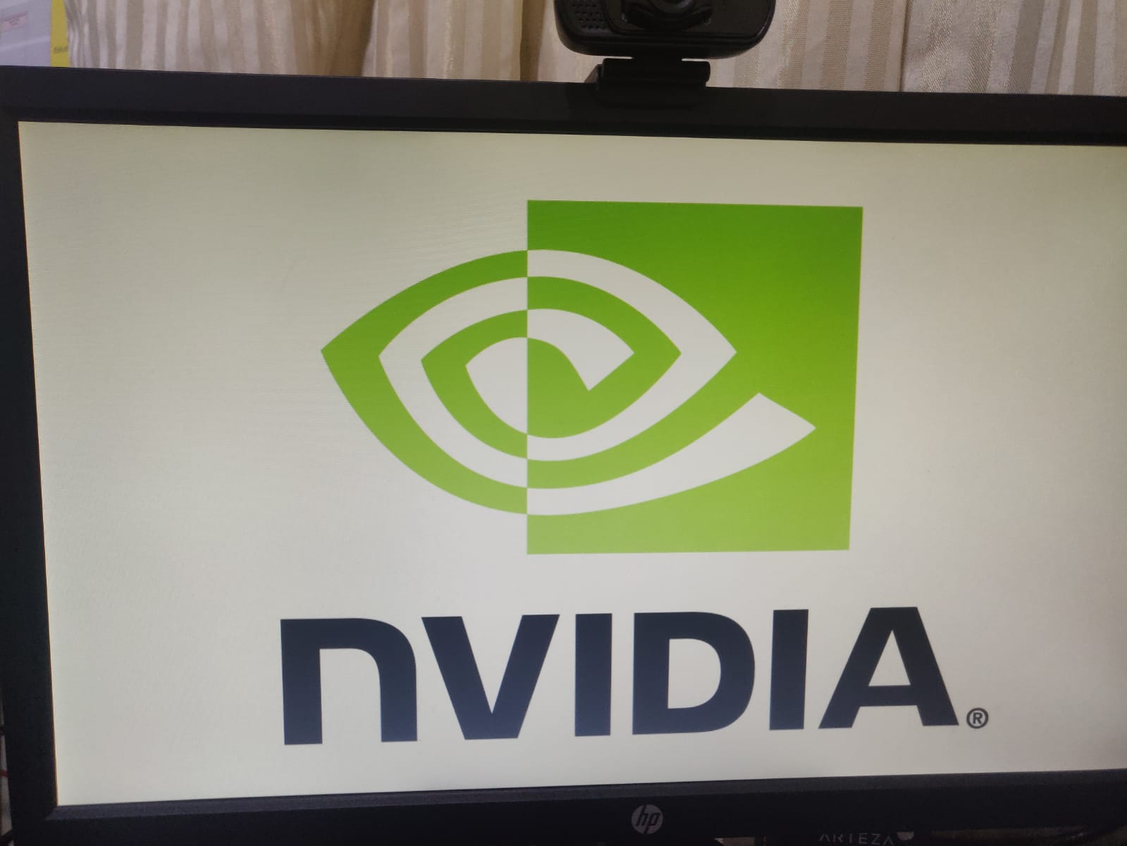

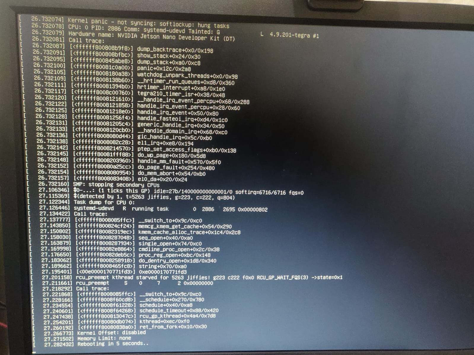

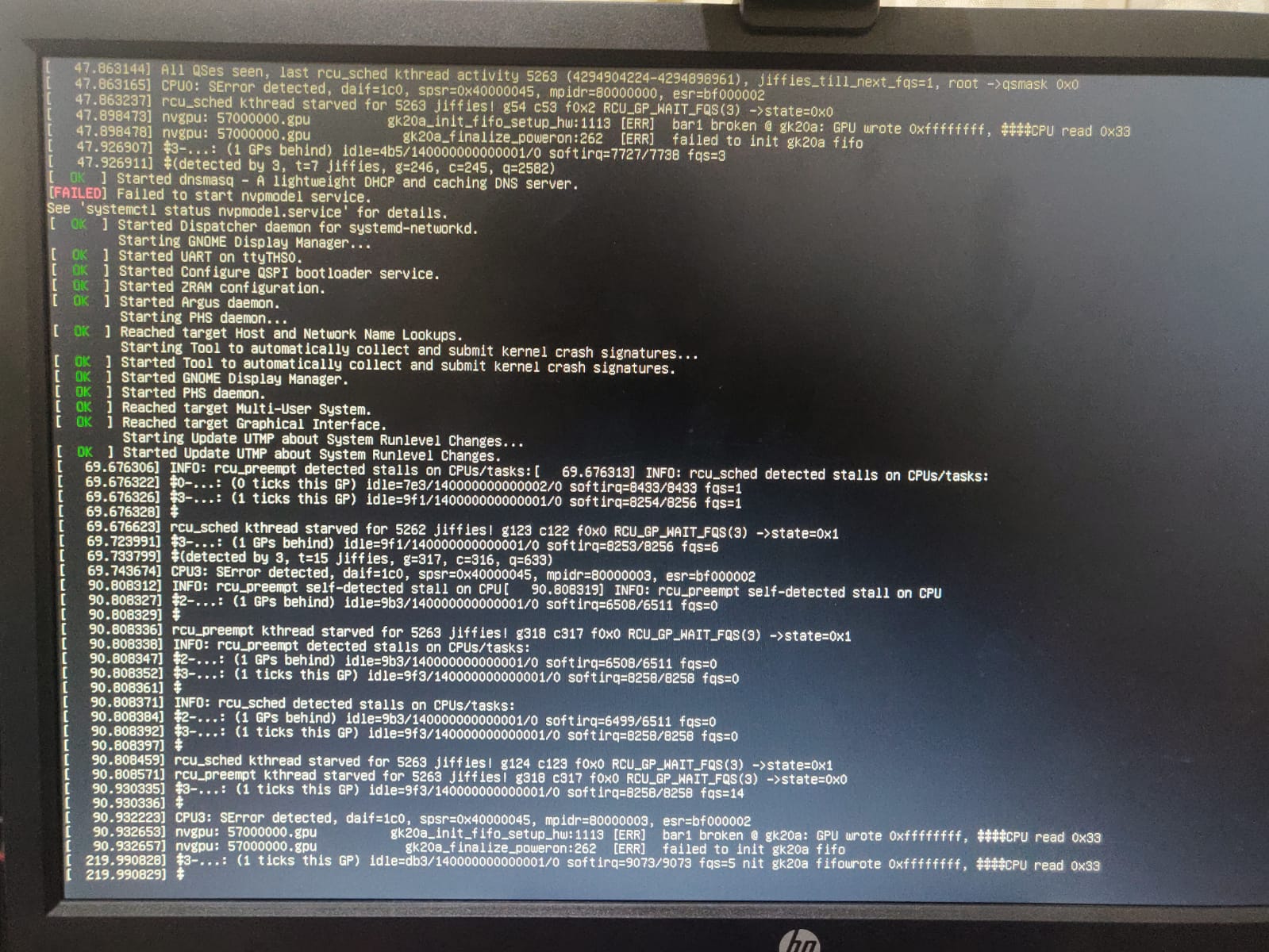

UPDATE:
I left the nano trying to boot for a loong time. It just could boot. I manage to take some pictures I will leave them below. These images were taken a long time after the jetson was sent to boot after user, password and time request during first boot.
The process is that frist i get the error shown in the fisrt comment, then the screen when off for a second and show the frist image with that black screen, and followed by the second image with more text.
Then the NVIDIA screen showed (I was really optimistic, but …), then the same black screen showed again, also here you can see a FAILED mentioned [failed to start nvpmodel service.
This behaviour happens every time that I unplug and plug the power supply to boot the nano.
Thanks in advance for any help.

Can you set up serial console with below link, remove the monitor, boot up and see what log do you see?
I think the tegradc error is not the main cause of your problem. Those errors of CPU SError, mc-error and gk20a error should be fatal one. The whole system looks unstable.
