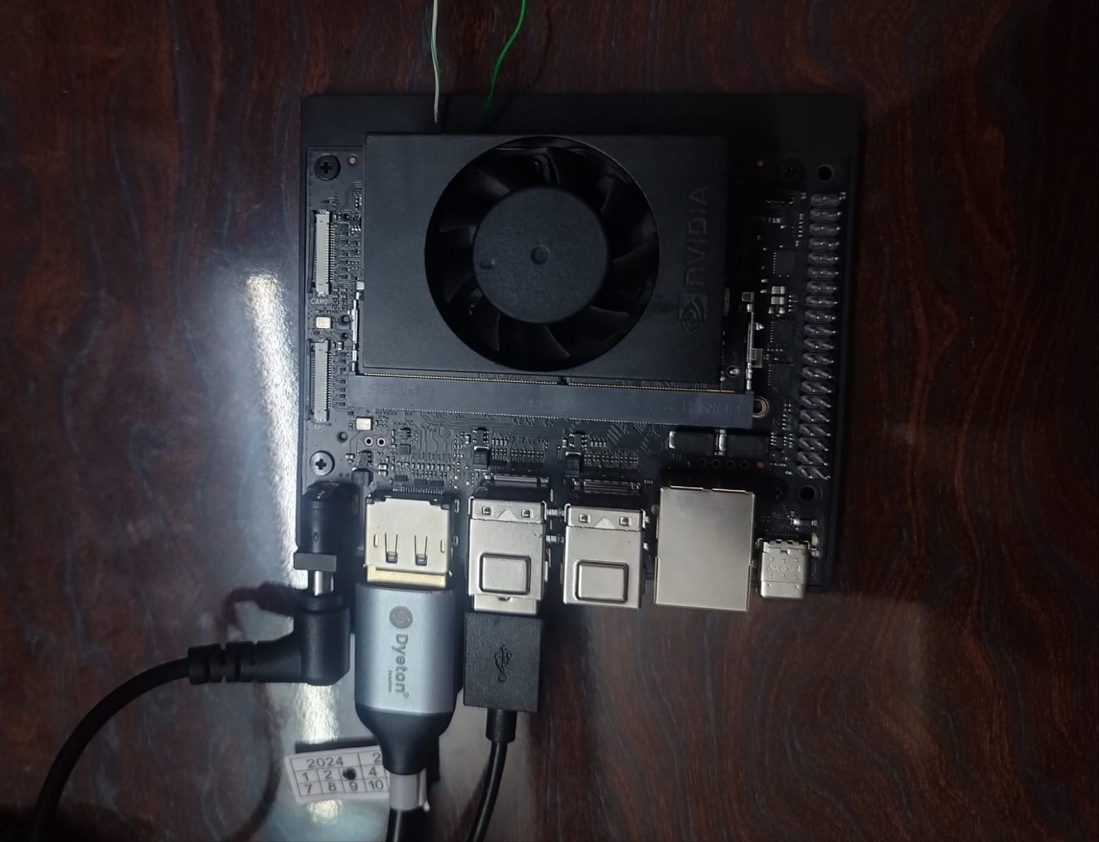

I am using the Jetson Orin Nano Developer Kit. When I power on the board normally (not in recovery mode), I see several “FAILED” messages appear during the boot process on the connected monitor.
I have not flashed the board recently, and I am using the default Jetson Linux provided.
HDMI output appears
Fan spins
But many services show FAILED status on boot
Examples of what I see:

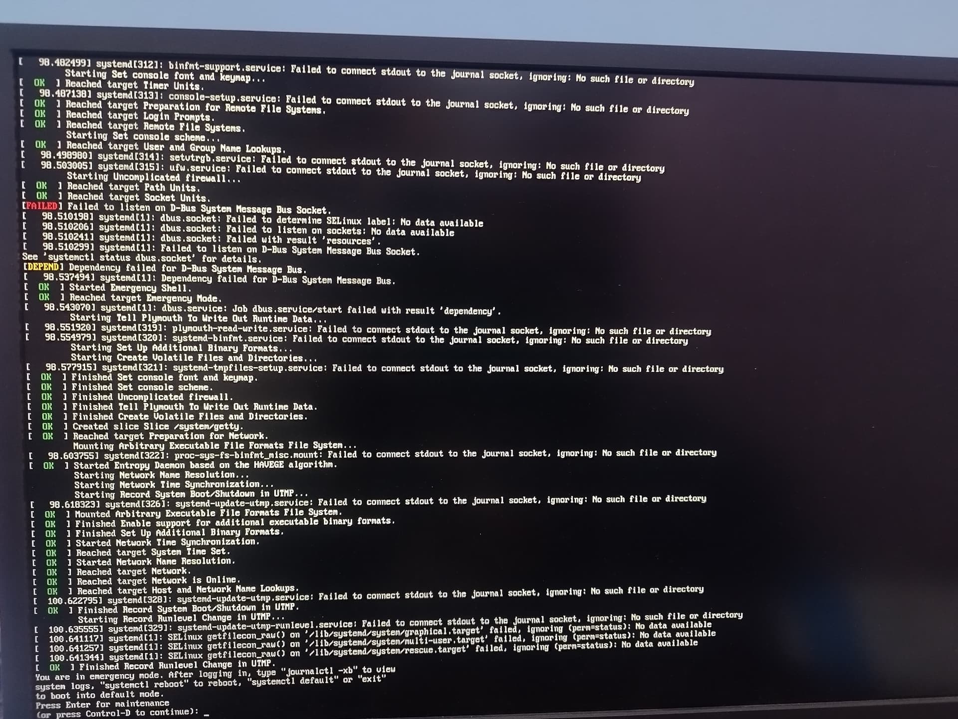

  • Failed to start Hostname Service
  • Failed to start Login Service
  • Failed to start Load Kernel Modules

Do you use an HDMI adapter because our dev kit only supports DP?
Yes, I am using an HDMI to DisplayPort adapter because my monitor only supports HDMI.
Could you please confirm whether this type of adapter is compatible with the Jetson Orin Nano Developer Kit?
I’m facing an issue where the board powers on, but I see “FAILED” messages during boot, and there’s no display output on the monitor.
Could this be caused by the adapter or display compatibility?

Just a comment on one of those errors, the part of Load Kernel Modules error. Regardless of the reason for failing to load modules, this implies none of the drivers or hardware which have drivers in the form of a module will work. Maybe (or maybe not) things like host name service depend on that, e.g., if the network hardware used a module format driver, then host name service could not succeed.
The base kernel Image has its location for where to find modules hard wired into it at the time of compile. There are actually multiple kernels possible on most Jetsons, and perhaps it is loading something other than the one expected due to a filesystem issue. Is this a dev kit, booting to SD card? Or is this a third party carrier board? It changes some answers.
Regardless of the answer, it is likely that the Jetson will need to be flashed. You wouldn’t necessarily need to flash any SD card though. It’s hard to give better advice without knowing exactly whether this is a developer’s kit, or if it uses a third party carrier board, or if it boots to some alternative media (such as NVMe).
Bottom line though is that it cannot find some content on the filesystem, and this triggers a chain of failures.

The HDMI to DisplayPort adapter shouldn’t be a problem. Adapters can still fail for various reasons, but that part is usually not a problem. VGA adapters basically guarantee failure.
Have you performed any kind of kernel customization? There is an initrd which is actually the first loaded filesystem. The kernel comes from the SD card for an Orin Nano dev kit, but the first module load is then from the initrd which is also in “/boot”. If the initrd is not found, or if the kernel is not found, or if the modules found in the initrd are incorrect and not compiled against that kernel configuration, then I would expect this to fail. Summary:
  • Kernel Image is in “/boot”, and this loads.
  • Module load is expected to find compatible modules in “/lib/modules/$(uname -r)/kernel”.
    • That location exists on the SD card, but this is not the first location searched or loaded.
    • There is also a “/lib/modules/$(uname -r)/kernel” in the initial ramdisk. This loads first, and it looks like maybe it was never reached.
    • This initrd acts as a kind of adapter between first kernel load and actual filesystem load. It is a simplified o/s filesystem tree purely in RAM. The Image is not from the initrd, but what the kernel Image loads is from the initrd. Then there is a pivot root whereby the “/” of the filesystem is transparently switched from the “/” of the initrd and the SD card’s ext4 filesystem. Logs usually mention these events, but I don’t see them.
  • You really need a serial console boot log to see events and to know for sure. Serial console would show exact details which the video isn’t really able to show. There are some variations on hardware for serial console, but this should be useful:

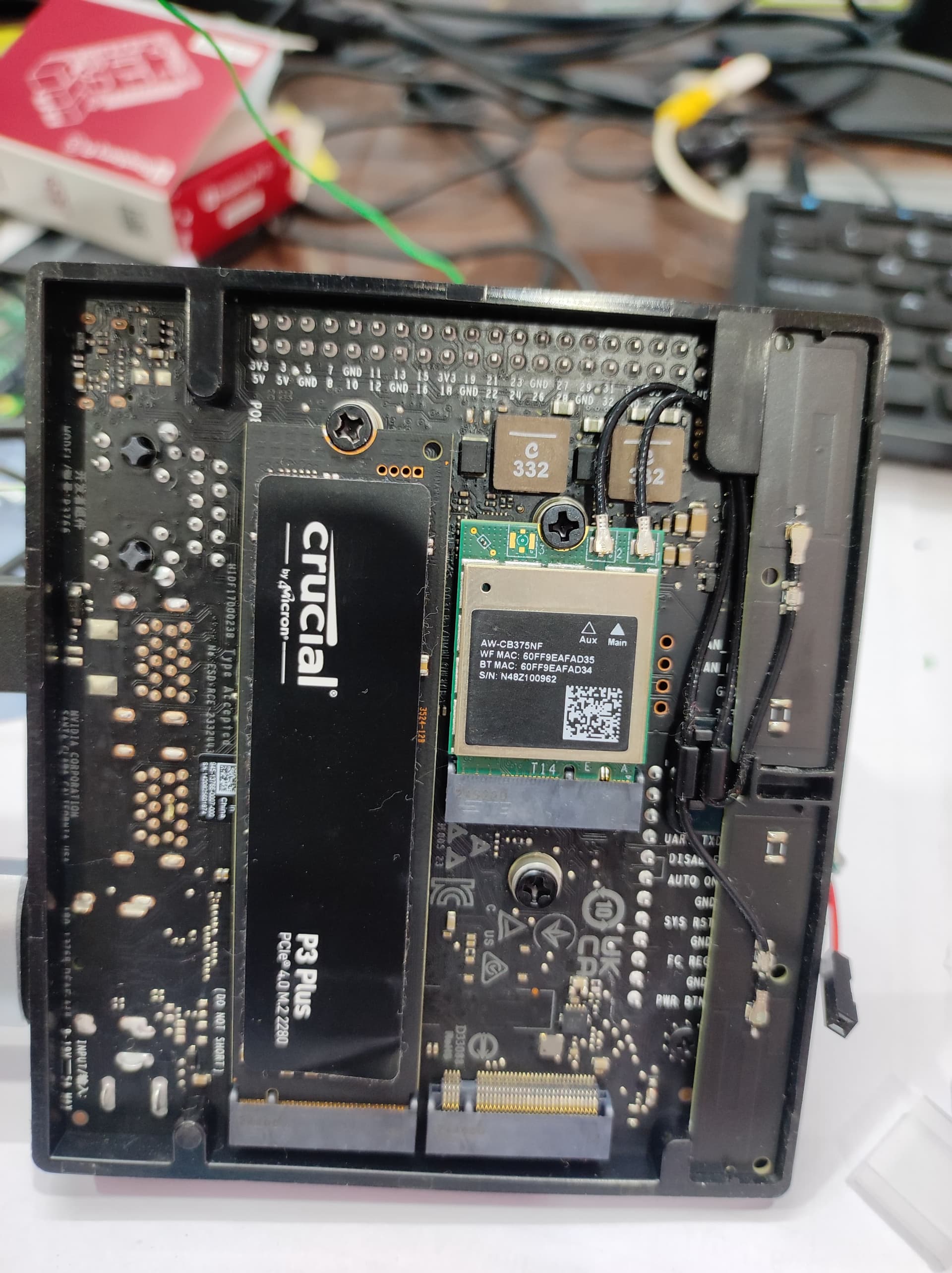

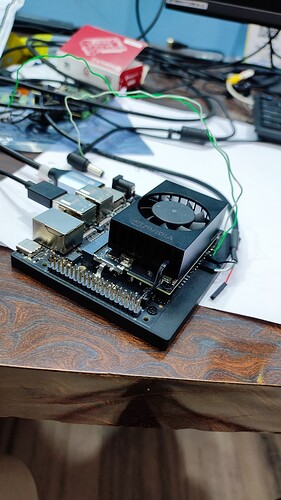

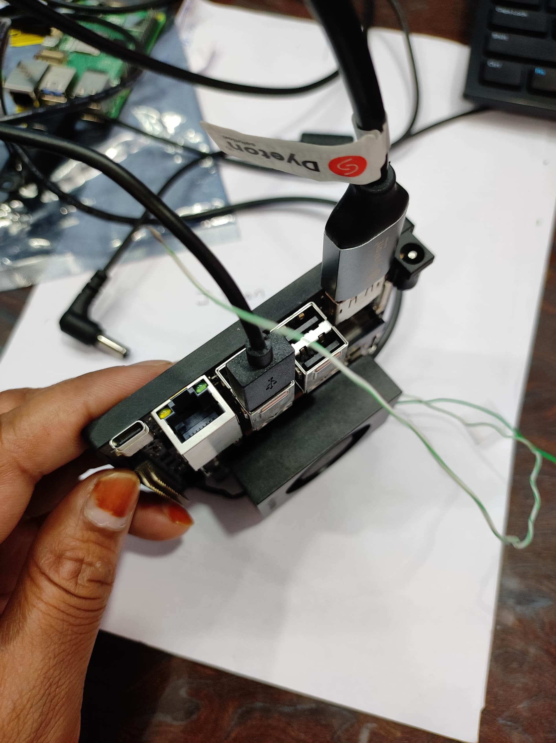

  • The board has an SD card slot, I am not using it currently. I apologize if there has been any confusion regarding this. I am not performing any operations related to the SD card at this stage. My only requirement is to get the board to boot normally again.
  • I have connected a UART cable (TX, RX and GND) to the board. I am able to observe the boot logs via the serial connection. I have attached the complete log file here for your kind reference, so that you can check the exact error message that is appearing during the boot process.

Your external media is being found via the initrd. I don’t know yet if the filesystem recovery lost something important (I’m taking notes while I read, I haven’t read it all yet), but it did find and try to repair the ext4 partition on an NVMe:
[    8.015077] nvme nvme0: 6/0/0 default/read/poll queues
[    8.017297]  nvme0n1: p1 p2 p3 p4 p5 p6 p7 p8 p9 p10 p11 p12 p13 p14 p15
[    8.360975] EXT4-fs (nvme0n1p1): recovery complete
[    8.361907] EXT4-fs (nvme0n1p1): mounted filesystem with ordered data mode. Opts: (null). Quota .
[    8.369637] Rootfs mounted over PARTUUID=a8abf817-da8b-4459-8dae-63ad1c9933ed
[    8.376683] Switching from initrd to actual rootfs

Some errors are unimportant, e.g., if you don’t have SElinux in use, then the SElinux label issue does not matter. My assumption though (and this could be wrong if there is some change I don’t know about) is that your system is not trying to enforce SElinux. I see no signs that SElinux has any meaning for your current issues.
I do see module or pseudo file failures. This is likely the problem (although just a symptom of something else related to filesystem corruption). It seems to be having problems with pseudo filesystems, i.e., things related to the kernel producing fake files in RAM looking like files which are really drivers…if the driver cannot load, then it cannot produce a pseudo file. Some of this includes boot related content, like the EFI (boot is out of EFI already, but EFI provides data or context to the running system; this could be on QSPI, but I’m thinking this is on the NVMe…maybe not, this isn’t certain; some content might not be used and might not matter). The bottom line is that anything not integrated into the kernel itself does not seem to be loading.
Basically, services needed for normal startup fail and it drops into a recovery shell:
Press Enter for maintenance
(or press Control-D to continue):
  • First, is this L4T R35.x or is it R36.x? This changes a lot, and you don’t want to mix instructions or software from one with the other.
  • Is there anything on the NVMe you need to save? If so, do you have a second NVMe to try or do you have a Linux system with enough space on it that you can copy the entire partition to it and not run out of space? The NVMe, when placed on another computer, can easily be cloned and saved in ways which work to save data or use it with flashes.
  • Do visit the Linux_for_Tegra/tools/kernel_flash/ location and examine the README file. There is an initrd flash script for use with the NVMe flash; other flash methods might appear to work, but won’t actually boot correctly for your situation.
  • If you don’t care about the NVMe (this is where the corruption appears to be), then you can just initrd flash. If you care about the NVMe, I can tell you how to save as much as possible before flashing again.
