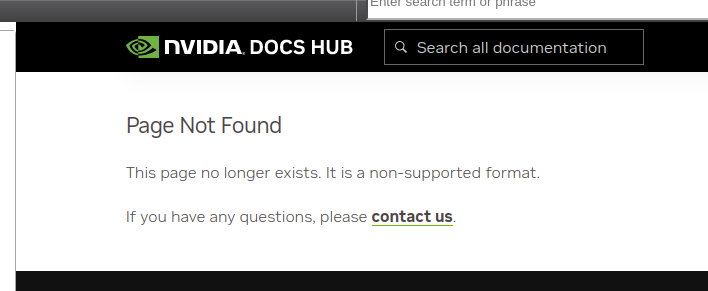

OK, conclusion is driver need to be installed independently(GPU is rtx 2080ti, already done)
How should I do after flashing with SDK manager(boot target board, display is disabled), I found those materials, but pages is not available anymore.
I remember it is described in the youtube vedio, too. but it is also not available anymore.

GPT tell me to use minicom to monitor the port, there is USB0-15 to be displayed after plugin to debug, which one should I use?

If you are trying to flash DRIVE OS 5.2.6 using sdkmanager, Once flashing is successful, please see Install DRIVE with SDK Manager :: DRIVE Platform Installation Guide with NVIDIA SDK Manager
