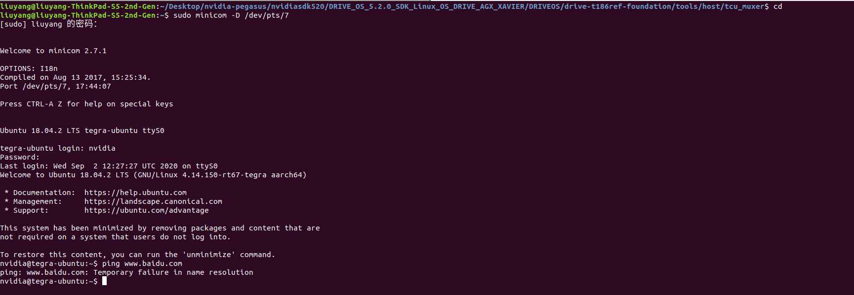

Current situation :

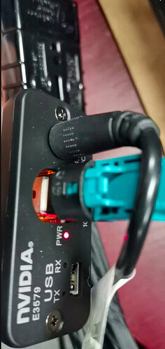

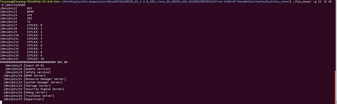

I connect the Pegasus per Ethernet like this, and the light of the device is also in the following image

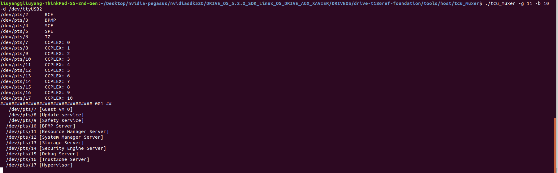

I connect the host and target pegasus per
./tcu_muxer tcu_muxer -g 11 tcu_muxer -b 10 -d /dev/ttyUSB2
sudo minicom -D /dev/pts/7

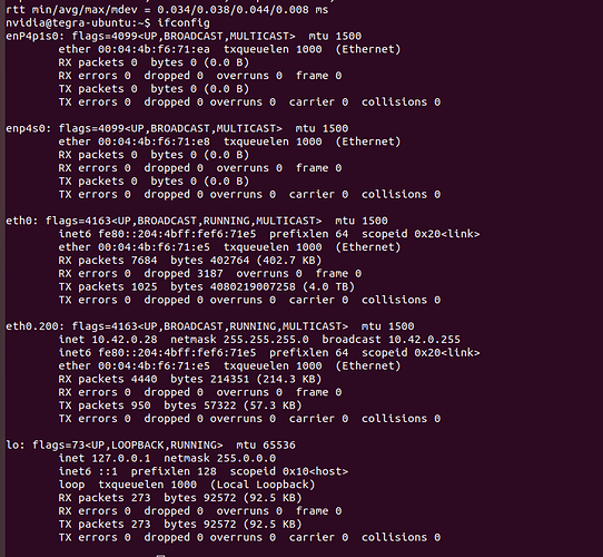

if I execute
ping www.baidu.com
the result is
ping 8.8.8.8

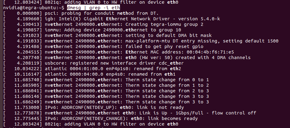

dmesg | grep -i eth
I could make sure the ethernet is OK , even though this is one device could convert WIFI into ethernet signals , when I connect this ethernet with my laptop , it could provide internet signals .
Could you please kindly help me , how to resolve this problem , and could let my pegasus connect with the internet

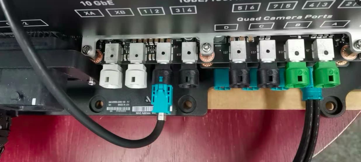

Could you also share which port it is connected on the target?
Dear @yang.liu1,
In my experience there is no need to make any changes to enable internet. We get eth0 IP from the DCHP server. I have connected to 3/4 port using dual gbe dongle. Could you check if chaging port or restarting target/networking service help?
- Restart does not helpful
- change the port from 1/2 to 3/4 does not helpful also
- How to restart networking service
I want to connect the network per Guest VM 0, is this the reason why I could not get access the internet ?
Dear @yang.liu1,

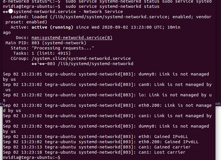

You can use sudo minicom -D /dev/ttyUSB2
to connect to tegra A terminal. Could you check sudo service systemd-networkd status
also date

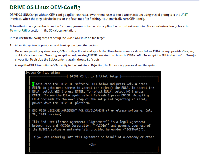

From one blog said
from this pic , it said I need to update the default username and password :
see :
https://docs.nvidia.com/drive/drive-os-5.2.6.0L/drive-os/index.html#page/DRIVE_OS_Linux_SDK_NGC_Development_Guide/Board/board_e3550.html#wwconnect_header
But I could not see any operation env like this :
Does this means I need to reflash the pegasus again ?
If this is the reason , how could I operate immediately after I flash the pegasus ?
