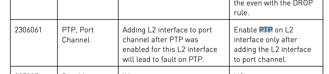

This sounds like an order of operations issue with enabling PTP on a port-channel. Documented in issue 2306061.
Can you blank out the interface config, add interface to port-channel and then enable PTP?

Hi Charles,
We reconfigured the port-channel and enabled the ptp after configuring the port-channel on the interfaces. You were right and everything is working perfectly!
