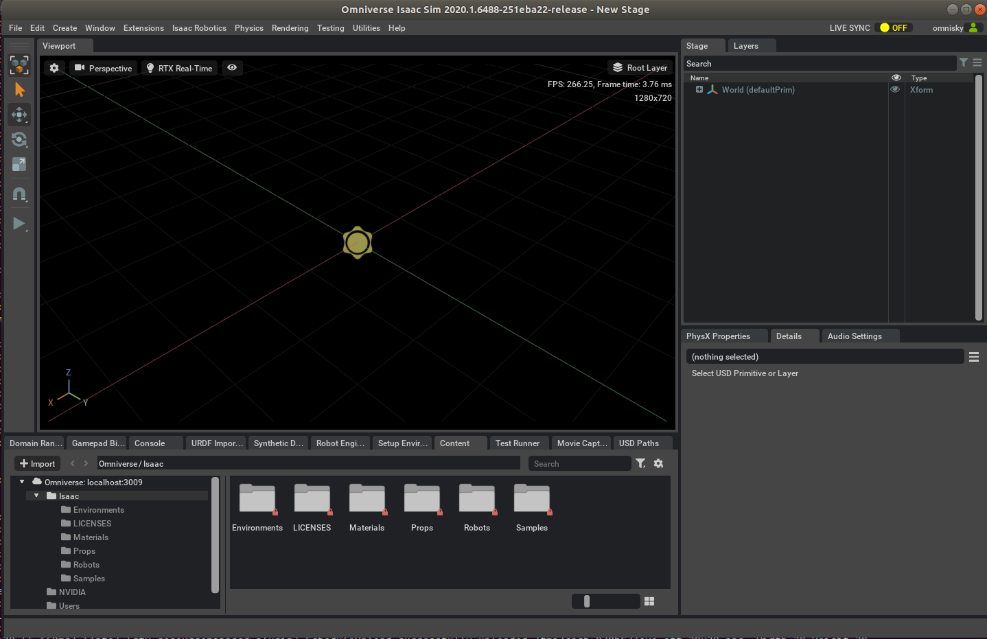

Thanks. You are right. It’s the drivers. I use the 440 drivers. It runs normally.

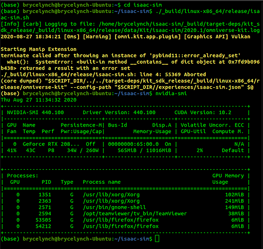

I’m experiencing the same errors. I’m running 440.100 driver and still getting core dumped. Any suggestions for a fix?
