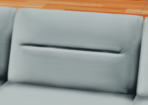

Example:
Pillow with diffuse and normal map on UV-set 0 (textures are tiled)
Pillow with diffuse and normal map on UV-set 1 (textures are wrapped around)
Pillow with detail-normal on UV-set 0 (I´ve disabled diffuse und and normal to make the problem more clear)… detail normal is now tiled like diffuse and normal map
Pillow with detail-normal un UV-set 1 (the detail normal is now wrapped around the geometry and create a nice wrinkle)
What I need is diffuse and normal map in UV-set 0 and detail normal und uv-set 1.
The ability to specify UV-set-index per map would make sense (like the translation). From my point of view, it does not make sense to use the same uv-set-index for every map… that renders the whole idea about different uv-sets on a geometry useless.
Carl
I’ve adapted the OmniPBR material and changed it in a way that it exposes a second UV-Index-property… and that worked at the end…
