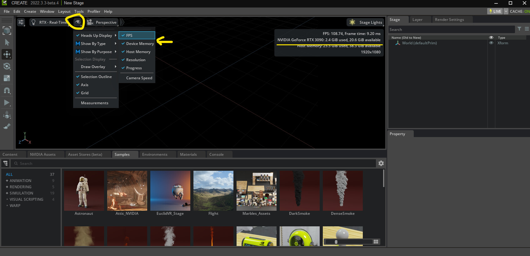

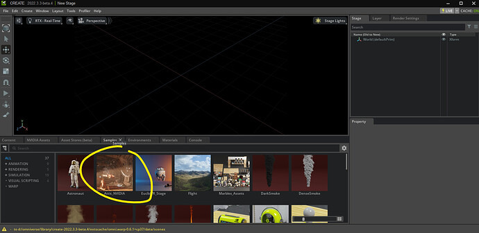

Create is just crashing when trying to export a subset of another scene ? Is does not crash when just viewing the AEC samples ? This could be because you are maxed out on memory. Please load the “Attic” scene in “Samples Browser”. Then open up the memory display information. See attachments. If it goes RED, you are out of memory.

The Attic scene seems to work fine:
When switching the render delegate to “Pixar Storm”, CREATE freezes for 3+ minutes and then the overlay goes red (RTX 3060 Ti 7.9 GiB used, 0.0 B available), but it does not crash (and the scene is rendered).
