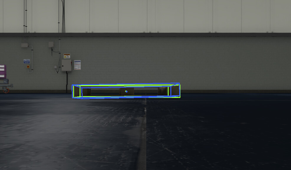

Making (great?) progress. The following image shows the machine learning model detecting an object (in this case, a pallet) as well as it’s pose. Green is ground truth, blue is prediction. A little cherry picked as the model is only 5% through training at this point. So all looking good!
Key elements are:
  • Isaac SIM to create synthetic environment
  • Python code to run the SIM and capture the data. The provided code had to be modified a reasonable amount.
  • Conversion code to put data in the format for EfficientPose (close to a standard), though this also requires some conversion on pose/translation
  • Training EfficientPose model.
Probably worthy of a Medium article - lots of lessons learned in there!
