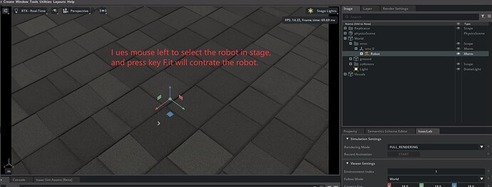

In my environment, I can’t see my drone, even though I clearly added it to the stage. You can check my specific settings and console.However, I believe my code is running normally. The code can train correctly, and it’s effective training, because I mapped the aircraft’s coordinates into a small marker so I can see its trajectory. But I can’t see my aircraft’s attitude/orientation.

@xihuanafeng111 i am just another user but wonder if you could take a screenshot of what you see in the viewport (of its entirety, including the viewport HUD) when you have the Robot reference selected?
Thank you sincerely for your reply. I will attach a screenshot from my viewport, where you will see the effect when I focus on the robot. I made changes based on the official quadcopter_env.py, and the official xform is not fixed to the Crazyflie. I’m not sure if there’s an issue on my end.

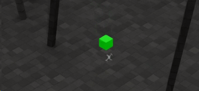

I have no idea to find my robot ,so i put a small a green cube to show it position, so that i know it works.
Thank you very much for your reply. While trying to provide clearer screenshots, I found my robot. It’s so tiny that I didn’t even realize it was there. Even a 0.1 size cube can completely cover it. Now, I have a small problem: how can I place this xform at the center of my aircraft instead of it being fixed on the ground like this, so it can follow me at all times?
my suspicion had to do with the scale, hence hoping the focus/zoom shortcut (F) would allow us to confirm whether the robot is actually in the scene. based on your latest finding, it does look like it’s in the scene. so, i wonder if it’s worth adjusting the default scale of the world or robot to make working with your asset easier. last i checked, Isaac Sim should be using meters as the default unit, so you can make a call yourself.

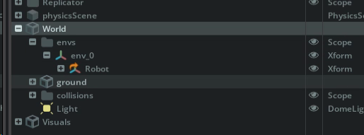

regarding the xform placement, could it be that the USD you are referencing already had an offset xform?

I’m also not entirely sure if the USD is offset. When I run the official Crazyflie demo, I noticed that focusing on the robot only centers it at the origin, not on the robot itself.

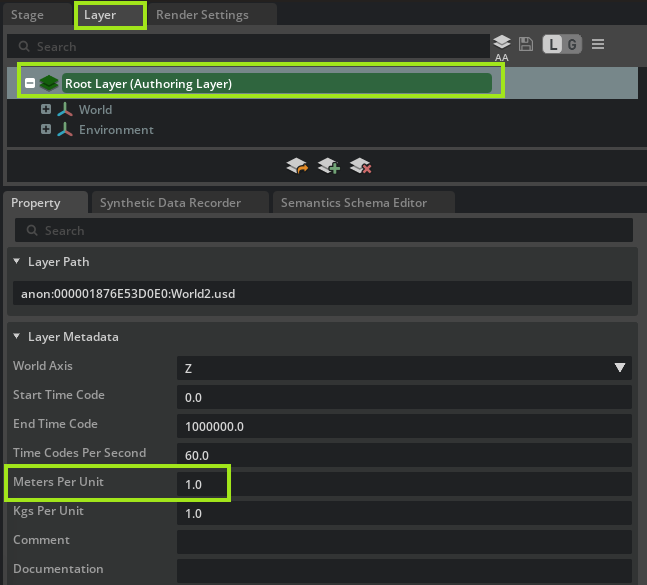

i suppose there’s only one way to find out by inspecting/opening the USD file itself and see whether the defaultPrim’s pivot is situated at the center of the robot or at the world origin.
if it is, for some reason, offset from the world origin, you could try moving the robot back to the origin and resaving (or save as a new USD if you’d like to keep the original) and see if the issue persists.
while you are at it, you can also verify the MPU for the source USD to address the possible scaling discrepancies:
