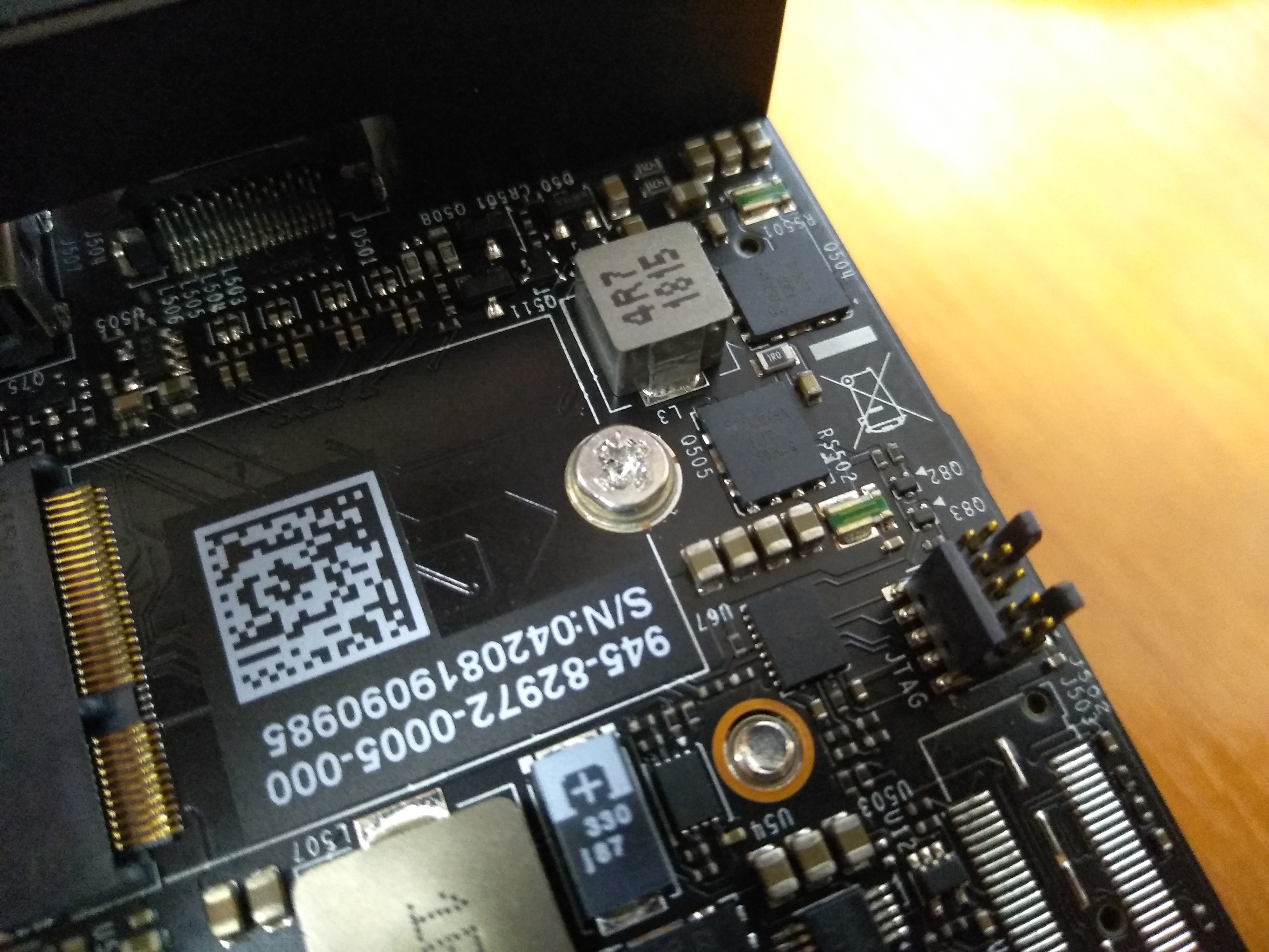

I decide to make a little upgrade for my recently bought AGX Xavier (plug M.2 SSD drive) but faced with unexpected issue, i just can’t unscrew the M.2 (M key) mount screw (under the cooler). I almost tore off the slots but still can’t get it out (afraid to damage the board). Plese note that screw for M.2 E key also cannot be unscrewed. Anyone faces the same issue?

Screw was right (simple cross one, with proper size) but now, when slots are almost tored off any other solution come to scene
Please note, i haven’t applied much force to unscrew it (just afraid of board damage), but screw slots are damaged significantly.
Photo attached
PS At the current moment screws (both ones) unscrewed (with extra tools) but i never expected that M.2 screws that just hold lightweight M.2 boards requires that much force to release (they both might hold whole cooler ^_^) Tnx for everybody who answered, looks like it is one in a million case.

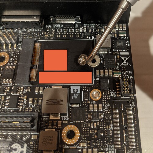

Pictured is not the SSD slot. That one is for smaller modules like WiFi and keyed differently. The SSD slot is hidden. Please see this video:
That screw does look mangled, however. I can’t say how it got that way. I will see if the screw is hard to remove on mine tomorrow. The SSD screw was not difficult. What screwdriver were you using (photo next to screw for scale)?
yep, picture is M.2 E key (both screws was the same so i managed to take a picture first one, without cooler removing)

I used ordinary screwdriver (as i wrote before, from ProsKit set Proskit 8PK-SD002N), just select one which fits well.
That is a key E slot, right, which is not normaly the kind used with SSDs. They exist, but are rare and slower. A key M ssd will not fit in a key E without an adapter and most of them I have used are flimsy. Adapters require ribbons that are typically too long and not high enough quality. The key M slot is intended for SSDs such as the evo series from Samsung, and is hidden underneath the heat sink. In any case, the screw came out just fine for the key E slot underneath. To be clear, both came out fine.
