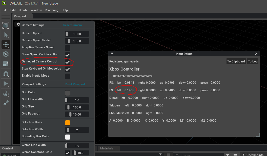

When I launch Create, any perspective camera constantly and slowly drifts to the right. Any ideas on how to fix this would be greatly appreciated!
By any chance do you have a gamepad or similar controller connected to your PC? If so, try unplugging it.
Thank you for the reply. No gamepad attached. Just mouse, keyboard, webcam, mic. Strange thing is that it eventually stops, but no idea why.
That is very odd. We’ve seen this sort of thing happen with some controllers. Maybe you have some sort of virtual controller in the system.

I was able to reproduce the problem of the Viewport camera shifting when “Gamepad Camera Control” is on and the GamePad is used.
I just checked with Extension’s Input Debug(omni.kit.debug.input).
My XBox Controller sometimes had a value of 0.1 or higher even when I didn’t press anything in Stick, and it seemed to gradually shift at this time.
If possible, could this threshold value be raised to 0.2 or so, or could it be adjusted in the UI to accommodate this?

@ft-lab! Thanks so much for your post. It helped our development team discover where the issue may be. The team is working on a fix (Internal Ticket OM-41164)
I had the same issue. After unplugging the controller I could solve it. I don’t see the use of controller input in an application like audio2face.
I also have the same issue, and unplugging the controller didn’t work for me. I’m using a Razer Tartarus Pro for quick shortcuts. How do you open the input debug window? I couldn’t search it from the documentation.
