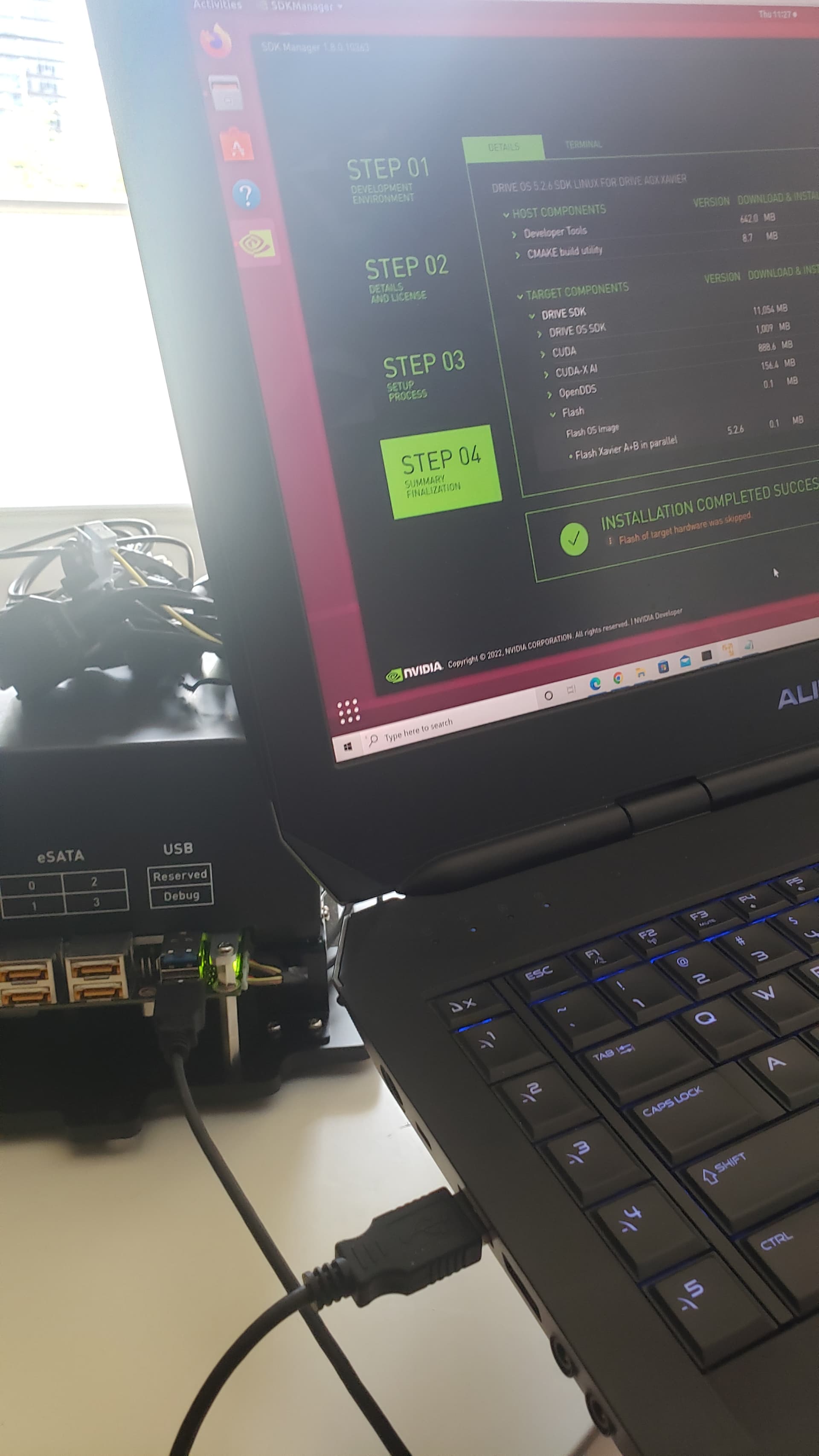

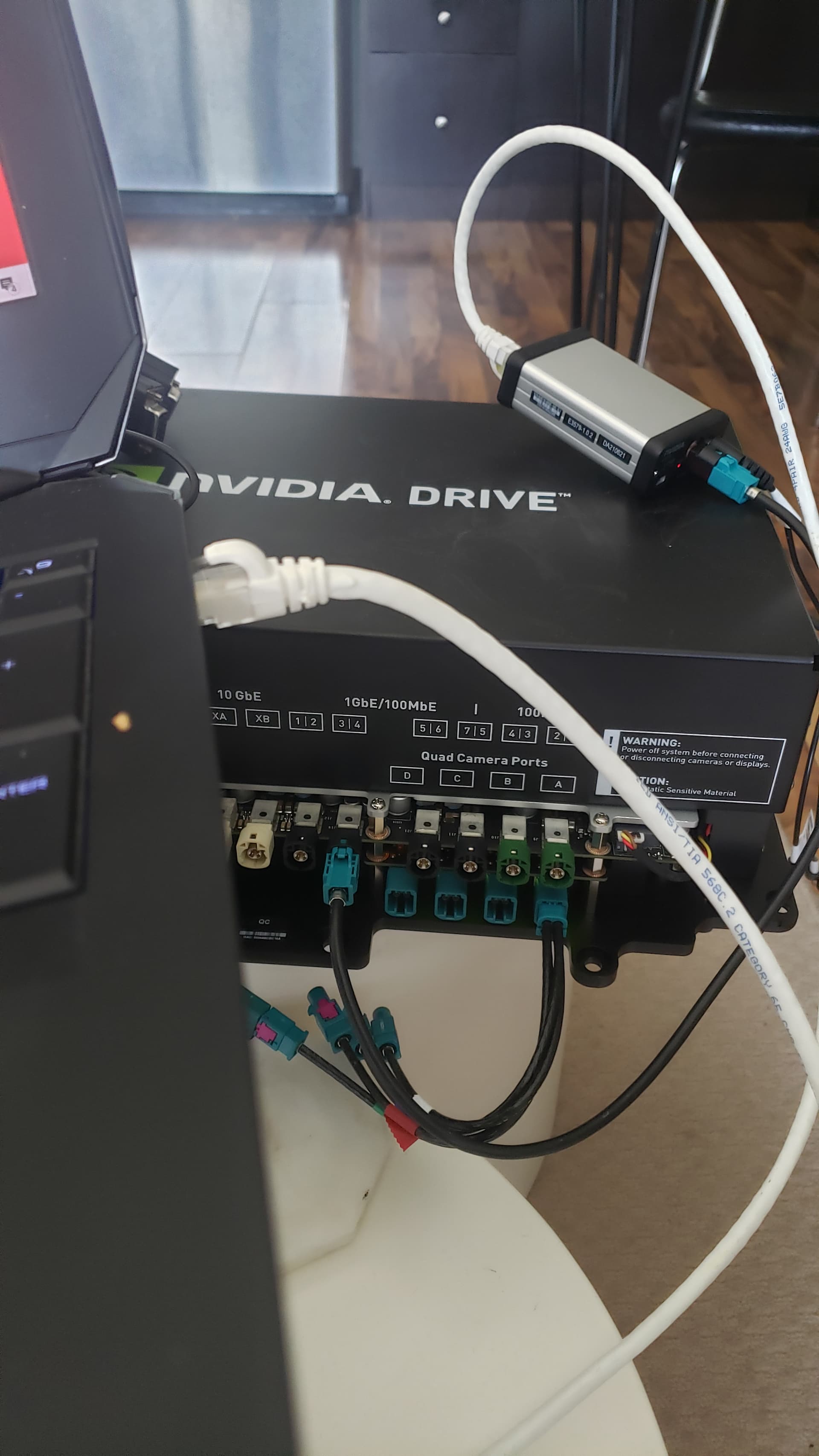

I am having difficulty flashing software to my device. I am unsure why it is not able to bind partitions but the flash fails immediately. I was originally getting a blue screen but after restarting I am able to see my desktop on the target hardware. I am unable to SSH into the machine (fairly unsure how to do it), but frankly I could use some help confirming how to properly do this as there was confusing directions within ethernet connection and I feel unsure if I have managed connections properly (I have connected ethernet cable from my host computer to Ethernet dongle, which is connected to 10 GBE port 3|4).

Please refer to Setting Up the E3550 Platform. You should use the USB 2.0 debug port to connect to the Linux host system for the flash.
Hey VickNV,
I do have the USB 2.0 Cable connected to the debug port but it doesn’t seem to recognize.

Are you using USB 2.0 A to A cable? Could you compare and share ~/.nvsdkm directory for my analysis?

Are you running sdkmanager on vmware virtual machine? It doesn’t support installation on a virtual machine.
Hey VickNV,
I was running on VMware Virtual Machine, I have tried it on a Linux Desktop and it flashed successfully. However I am no longer able to see the desktop when I plug in my hdmi cable to XA-1.
