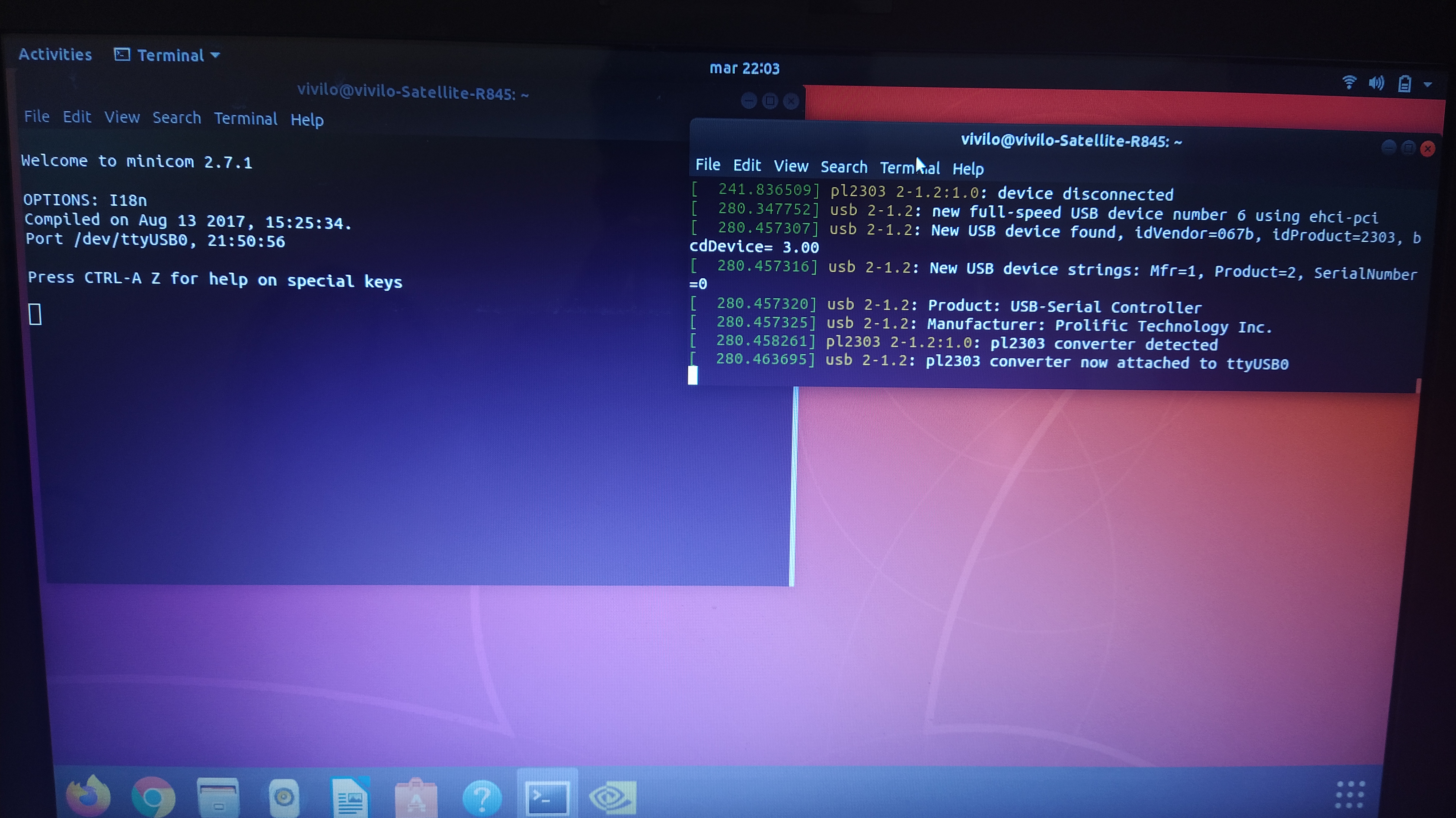

I have a jetson nano (P3450 ) and I’m using windows 10 and Ubuntu 18.04. I follow all steps like web site Nvidia (using balena and nv-jetson-nano-sd-card-image-r32.4.2b)… When attached microsd into the jetson nano on the screen appear only Nvidia logo and stay it there… nothing more. I flashed various micro sd in windows and ubuntu (using balena) but the result is the same.
I downloaded SDKManager on ubuntu and I flasing various microsd but the same result… The Jetson nano still on nvidia logo. I can’t to continue to create my login user
Finally I can bought TTL to USB converter cable and I use the tututorial by JetsonHacks Jetson Nano - Serial Console - YouTube The Serial Console is a great debugging aid for connecting your NVIDIA Jetson Nano Developer Kit… So you can see my results with this method.

What’s on the console when you reboot the Nano?

The left is console of Nano probably and does not show anything, isn’t it?

you’re right! It doesn’t show anything…
glemusvictor,
Jetson Nano would display any text on the serial console, even Ubuntu boot-up fails.
If it does not have any physical damages, SoC internal codes should run.
You’d better change the carrier board to another one.
