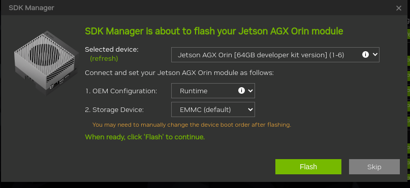

I follow Official user guide to Flash L4T BSP in Jetson AGX Orin CLB developer kit, it shows “installation failed” in SDKmanager.
SDKManager error:

I follow Installing JetPack you list install Jetpack in host worked. But flash with this instruction Wizard Flashing not work.
“OS image ready” in step 2 is reached in step 2.
At step 3, choose OEM Configuration runtime or Pre-Config both lead error.

I solved this problem by another post:
Q: I get a USB timeout error during flash Orin. How to resolve that?
A known issue for ubuntu 20.04 host is the USB autosuspend function is enabled on it by default. This leads to Jetson recovery mode gets suspended before flash. To bypass this error, need to:
Disable autosuspend on host PC with below command:
sudo -s
echo -1 > /sys/module/usbcore/parameters/autosuspend
Plug out the USB cable, put jetson back into recovery mode again and plug the usb cable back.
If USB timeout is still there after above commands, please file a topic to forum and let moderator help check.
After set this, I can flash jetson 5.1.3 into devkit.
