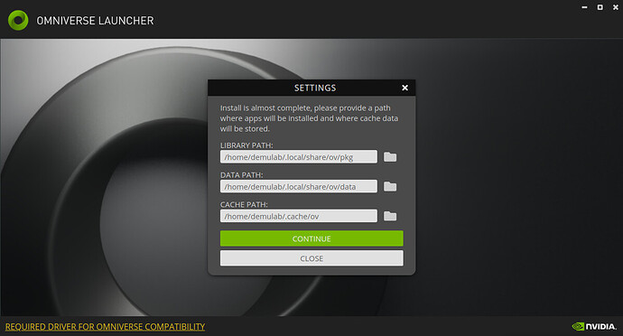

I want to run isaac sim using omniverse launcher. However, when I download the omniverse launcher and run the AppImage format file, I get the following image error:
I think that it will be solved if you specify a proxy or firewall, but I do not know where to write it. Could anyone please tell me?
Thanks you.
