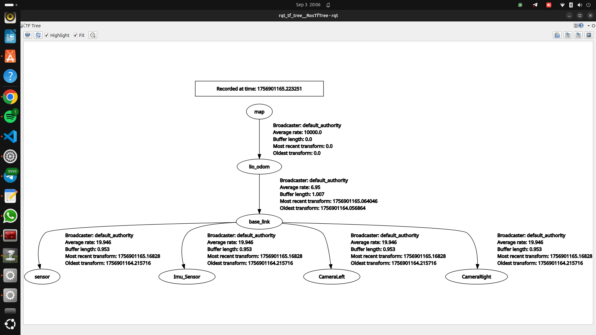

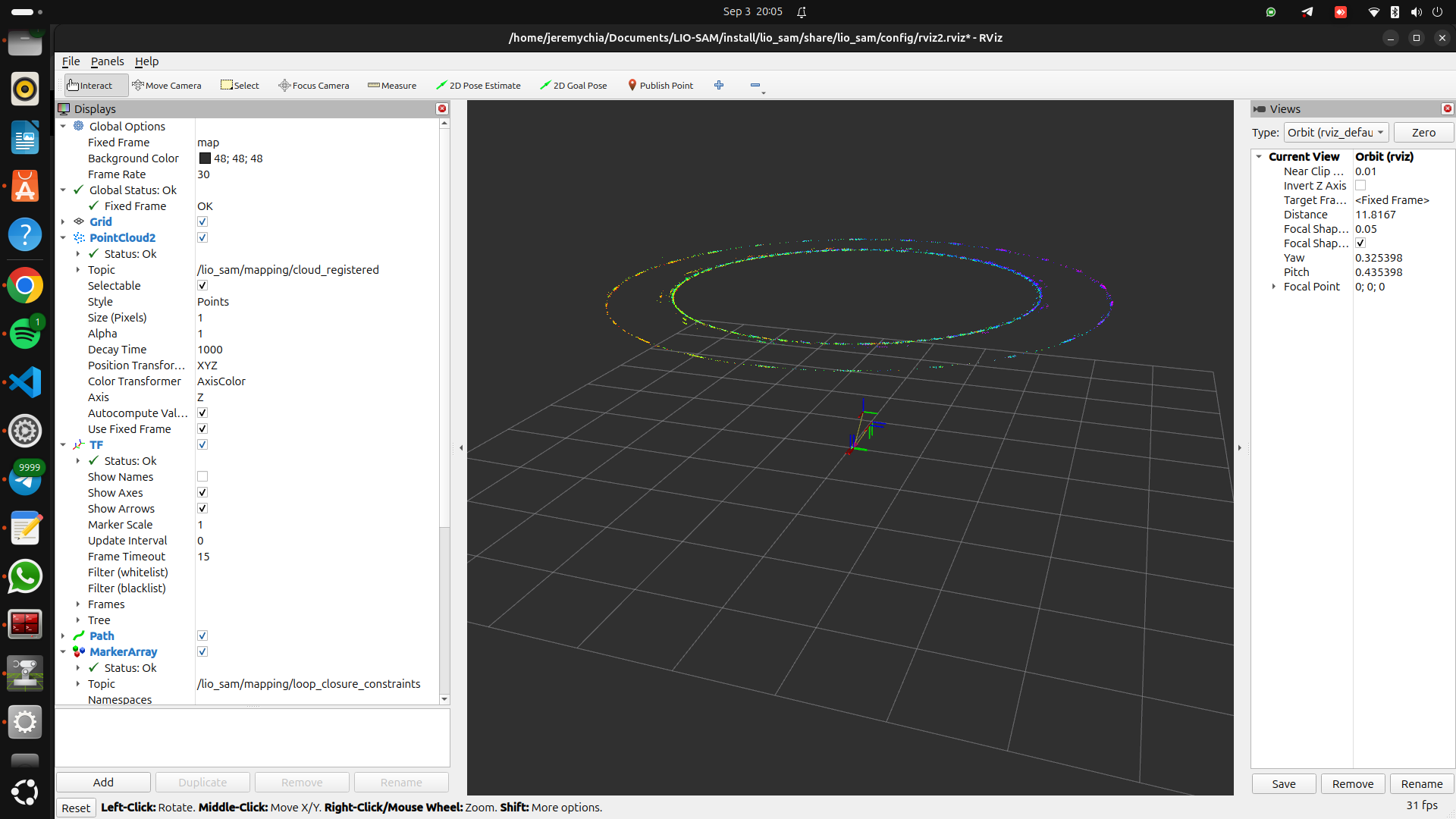

Hi @zhengwang , I found this issue to be reoccuring in Isaac sim 5.0, using ros2 Jazzy. I am trying to switch to Jazzy because my motherboard in my new Desktop does not support Ubuntu 22.04.05 LTS.
Attached are some screenshots of my results.
Attached here are a few more screenshots of the results, and a photo of the raw point cloud data with rings
Let me reach out to the internal team about this issue
This issue is expected to be resolved in Isaac Sim 5.1. Please stay tuned!
Apparently by increasing the maximum position count , maximum velocity count to 255, and times per second to 500 resolves the issue.
Under PhysicsScene
Hi, after further debugging, I can confirm that this works for me.
The graph has to be set to On Physics Step and ‘Stage on Demand’ in the graph’s raw USD Properties. In addition, the time per step must be increased from 60
Thanks @Tap2Play! That looks like a workaround. When Isaac Sim 5.1.0 comes out, please feel free to try it out and see if the issue persists.
