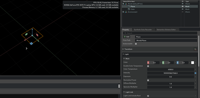

I created a mesh light using UsdLux, but it didn't work
I used UsdLux to create a mesh light, but it didn’t work. I want to create a hemispherical light source with light rays pointing toward the center of the sphere, to simulate uniformly scattered skylight. However, a DomeLight does not meet my needs.
First, I tried applying LightAPI to a plane. Although the light attributes appeared in the property panel, no matter how I adjusted the parameters, the mesh did not emit light.
My code is as follows

mesh_prim = stage.GetPrimAtPath('/World/Plane')
# LightAPI
print(UsdLux.MeshLightAPI.CanApply(mesh_prim))
meshLightAPI = UsdLux.LightAPI(mesh_prim)
meshLightAPI.Apply(mesh_prim)
links = meshLightAPI.GetLightLinkCollectionAPI()
meshLightAPI.CreateColorAttr().Set(Gf.Vec3f(1.0, 1.0, 1.0))
meshLightAPI.CreateIntensityAttr().Set(1000000)
UsdLux.ShadowAPI.Apply(mesh_prim)
Additional note: The figure below shows the stage I created, where I placed a large cube to check whether the light was emitting. In this stage, I used UsdLux.RectLight.Define(stage, ‘/World/Plane’) to create a light, and it worked properly as a light source.

Unfortunately we do not support anything custom like that. We have a domelight which does exactly that. Why does a domelight not work for you? It is a perfect ambient, non directional, balanced spherical environment light. Should be perfect for your needs.
If you tell me the overall goal of what you are trying to achieve in rendering, I can help you. I am sure we can set up a domelight to your requirements.
@Richard3D Thank you very much for your reply. I am currently working on a scientific computing system. I need to simulate the sky, where I can control the energy/power ratio between direct sunlight and diffuse skylight. The power of direct light can be directly calculated from the light source radius and intensity. However, at present, I don’t know how to calculate the power of a DomeLight, since its radius seems to be infinite. Therefore, I would like to define a custom DomeLight with a controllable radius.
Ok. So rather than using a custom dome light, literally just make a self illuminated hemisphere. It is just a sphere with inverted normals, you set the radius of the sphere dynamically and you apply a pure white or RGB self illuminated material to it with a known lux. Much easier. For the direct sunlight, just use a Distance light.
